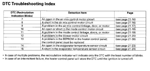

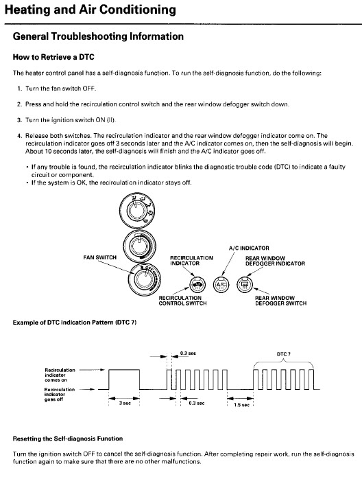

Check for a trouble code.

ok so i turned on the car ran the diagnostic check. i heard it do some stuff then nothing blinked.
then i ran the car till the air died out and did the check again with the same result.
one thing to note is that the a/c light does not come on during the test like the instructions say.
