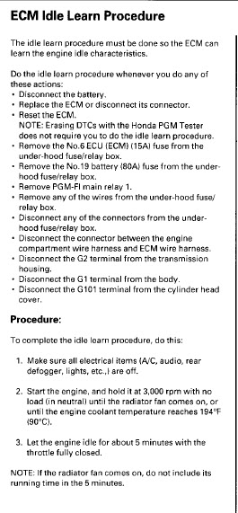

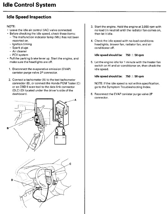

You don't want to replace parts at random. It gets expensive and frustrating. Any CEL codes?
If there are no codes, try this:
