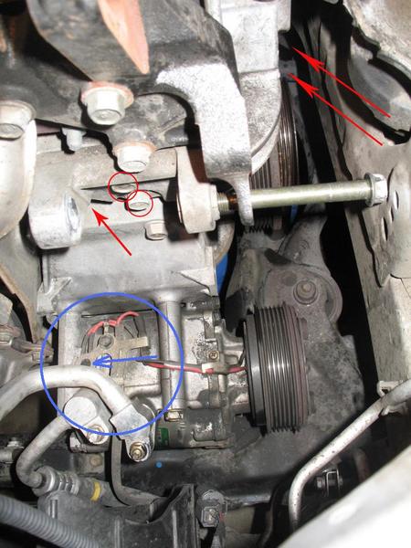

I was browsing reddawnman's Timing Belt DIY and cross-referencing with the FSM. It looks to me that, even though I could access the compressor pulley via the wheel well, accessing the sensor on top may be next to impossible unless I remove the PS pump and alternator. Check out these pics (shamelessly stolen from the above mentioned DIY... props to reddawnman).
The compressor shown from the wheel well... still appears hostile to working on it's top:
Ignore the red mark ups.. those are reddawnman's. My markups are the light blue circle indicating the wiring, sensor and clamp on top of the compressor and the light blue arrow pointing at the sensor itself.

So that's where the sensor is? I guess it would be easier to work on that from the top, but I was just looking at those wires the other day, and I didn't have any parts taken off. I'm not positive, but I'm pretty sure I could've worked on that without removing the P/S, and alt.. It might not be fun, but I think possible.
I just looked that sensor up on Majestic and it's $47.59 there.

I pulled my alternator and power steering pump to get at that sensor. The test for the sensor is to check continuity. There should be continuity if its less than like 200 degrees f outside.
