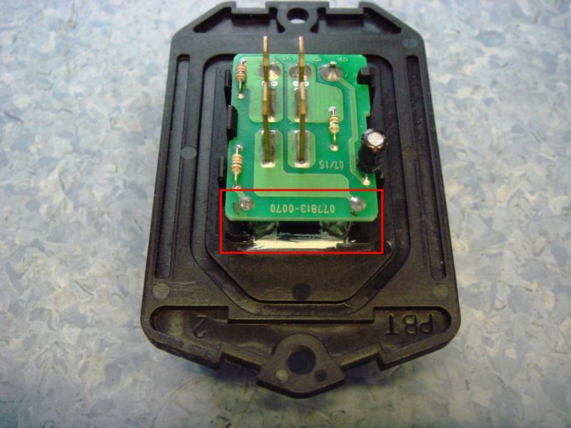

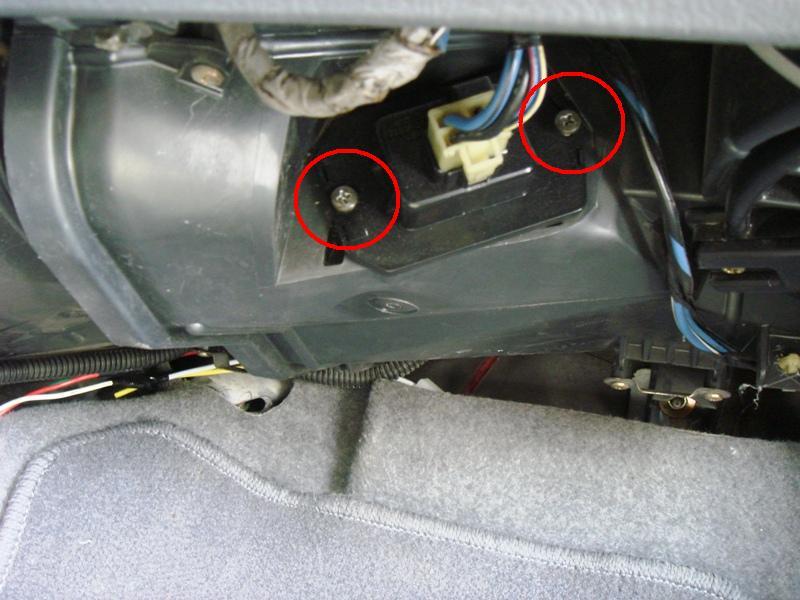

its your blower power transistor. its bad. you can get a new one or modify the old one. mod is way cheaper. the mod is you take the power transistor off and solder a 1kohm resistor between the open contacts. see pics answer courtesy of honda-tech member "jivi" heres the link http://www.honda-tech.com/zerothread/2041582

It works! Finally! I had been so frustrated and been driving without any air for the last month. The lowest resistor I found at Fry's was a 2.2 ohm so I welded two together in parallel to get an equivalent to 1.1 ohm and it does the trick. Can't believe its only a 50 cent fix! Props to you man!
