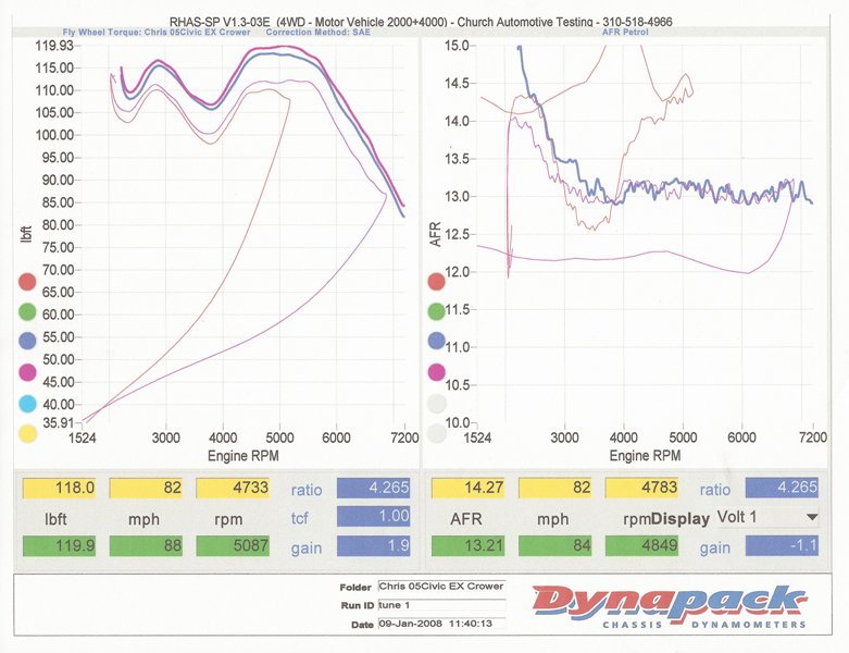

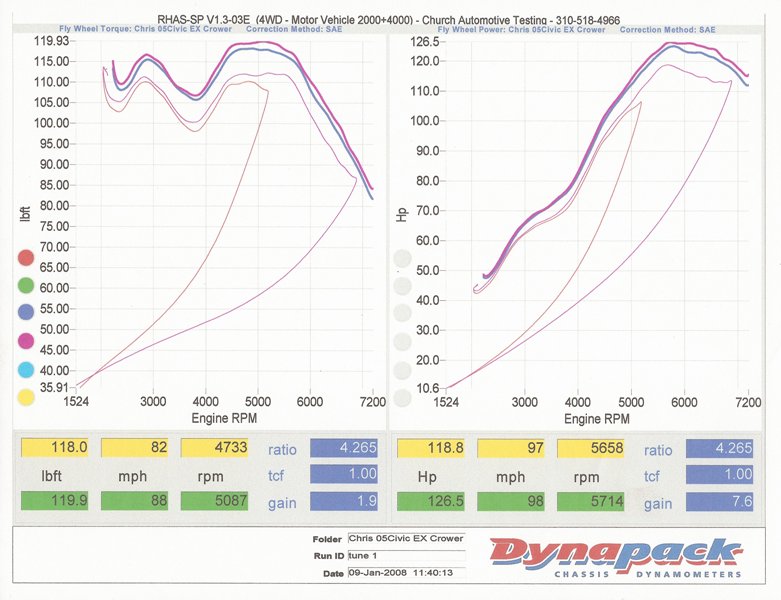

ok here it is.
He said I'd get about 5% more if I change the cat.
You guys think injectors would help too? if so what cc?
Corrent Engine mods:
V2 intake
Header
Catback
EMS
Cam gear
Stage2 Cam
Stage2 Cluch and 8lb flywheel
Other Mods:
Coilovers
Momo S.Wheel
17" Wheels/Tires
ID:	73456   Click image for larger version

TAKE YOUR CAR TO ANOTHER TUNER ASAP. Those numbers are too low man trust me. I made 124whp on the emangle. DJmota made 147whp with KPRO and you should be right up there in those numbers with EMS.
Also you should be fine with stock injectors. Ask your tuner what the duty cycle was but I bet they are no where near maxing out. Where was your redline on the dyno. With EMS you can bump it up and make some more power bc with that cam you can still make power above 7000rpms. Don't quit find out why the numbers are low and retune.

So with the EMS and the Cam. Red line can me moved?
They were redlining starting at 7000.
He said I get Free retunes if I think somethings isn't right or I don't like it.
As long as I don't add any more mods.

Did you get any HP numbers? Or did they only give you Torque?
Old Jan 11, 2008
  #48
oino's Avatar
Joined: Feb 2006
Posts: 52
oino is an unknown quantity at this point
Re: Car won't idle. plz help
The second image has the HP. on the right 126.5
Old Jan 11, 2008
  #49
99CivicDood's Avatar
Joined: Jan 2008
Posts: 10
From: Round Rock, TX
99CivicDood is an unknown quantity at this point
Oh, hah. I didn't realize there were two! What's the D17 normally put down?

ok this sucks and can't be right.
I didn't gain much at all.
I kept thinking that stock HP was 117.
Stock:
127HP SAE @ 6300 rpm; 114 ft lb @ 4800 rpm
Mods:
126.5HP SAE @ 5714 rpm; 119.9 ft Ib @ 5087 rpm
If Stock is 127 then I should be getting like 138 - 145 with all them damn mods
Old Jan 11, 2008
  #52
lordhelmet's Avatar
Joined: Feb 2006
Posts: 2,172
From: Irvine, Ca
Rep Power: 291
Don't feel bad. 127 is at the crank. You measured hp at the wheels. There is HP loss between the crank and the wheels.

stock is 110 at the wheels.
i hit 116 at the wheels with a VAFC2.
***** way off.
O yah you can redline to 9k!
