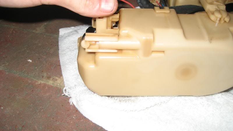

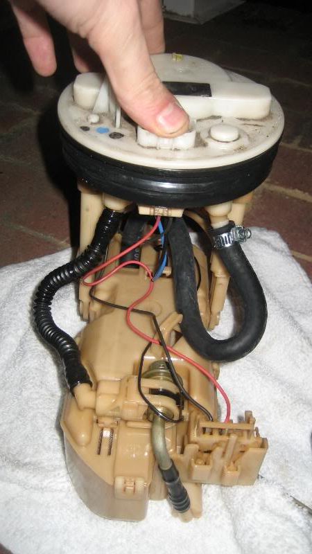

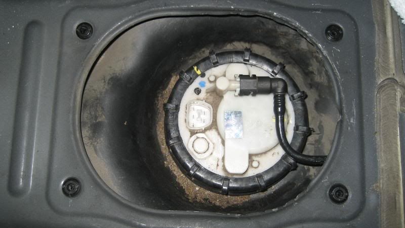

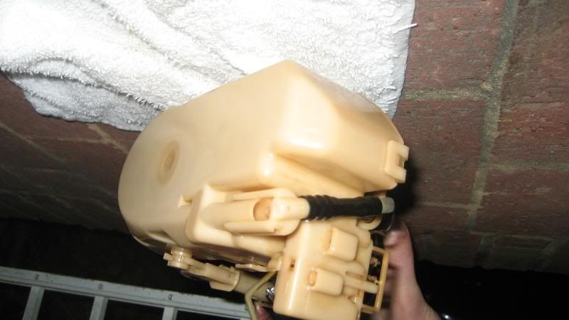

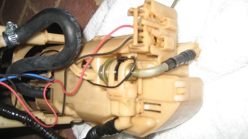

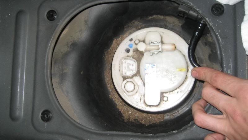

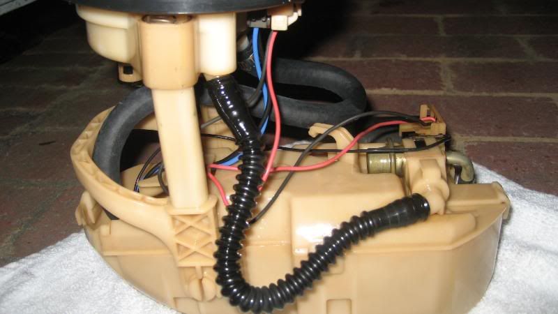

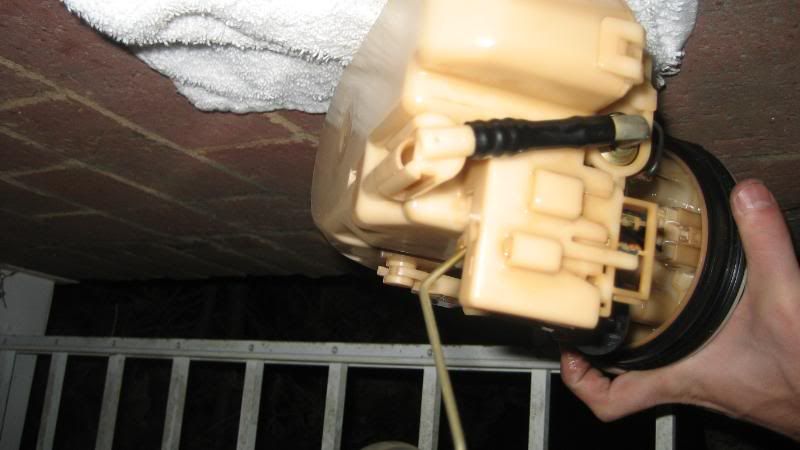

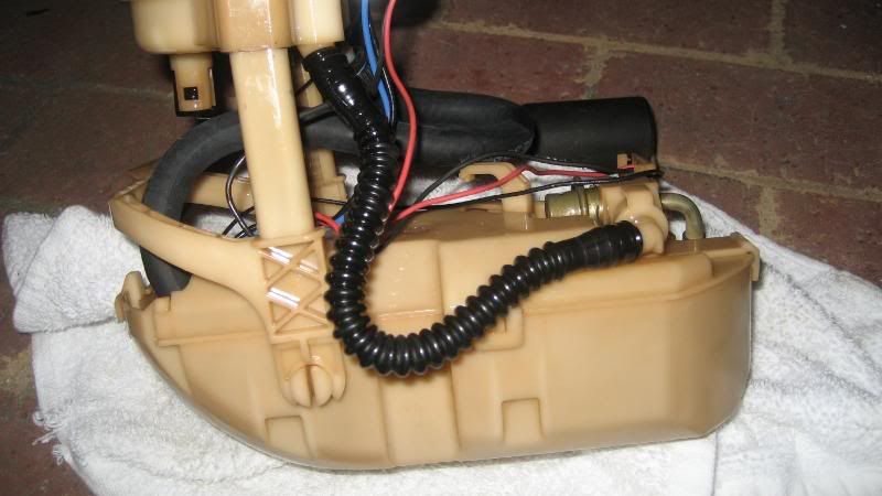

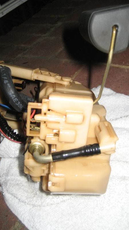

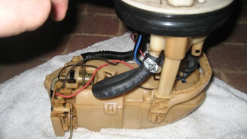

ok, heres the pics. in one of them the hose looks kinked, but its not. keep an eye on the lower of the housing as thats where the hose doesnt connect to anything anymore, im not sure if thats an issue or not...

so what is the point of the thing on the outide, im assuming thats the regulator right? its all done (fuel pressure regulation) in the housing up top and the excess gas stays in the tank, minimizing on fuel line that goes to the rail itself.. the bottom feed thats not connected to anything down there id assume is where the excess fuel gets poured out of, so it doesnt really matter if its connected or not, right?

ok, so now im answering my own questions. i see the spring in the regulator...
so it looks like my setup here in-tank is right?> whch means im prob getting the 43psi. so why arent my rsx's werking?? lol..........
and whats the u ring around the regulator with the ground wire used for?

Your pump set-up is fine, what turbo are you running? I would lean out at 5 psi with RSX-S injectors on my GT30. I'm also running the PCS-XFC. Those little guys just couldn't throw enough fuel. From what it sounds like, you're having the same problem - the injectors just can't hang.
As far as the u-ring and ground wire on the FPR, I have no idea.

Why did you change the hose to a rubber one? You may want to invest in a Submersible fuel hose. Look HERE . Standard fuel hose will eventually blister on its exterior and could cause a problem.
