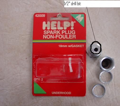

the none-fouler comes with 2 parts one of them you have to leave stock and the other one bore out w 1/2 drill. The o2 goes to the one you drill and the stock one to the exhaust.

well yea, the seconday one doesnt affect any, it just makes the engine light turn on cuz the secondary sensor is reading different air, so by the CEL coming on, thats what affex it, since it puts my computer on "default mode" thats why, hey but what do u mean the other stock non fouler goes to the exhaust? for an LX both sensors are on the header itself, can some1 draw me a sketch, or something, sorry for being such a noob at it, but when it comes to doing something "exact" i dont wanna screw up

take the first fouler and drill it out to .5". Then screw it on to the sensor, then screw on the second fouler then screw it into the secondary O2 sensor location....

i tried the mil eliminator, it didnt work, so now im gonna try the non fouler, but do i need 8mm non foulers, or which size? and should i just leave the eliminator connected to the sensors or should i take it off??
