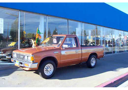

That sounds like the input shaft bearing, another real winner on this POS gearbox.
I'm driving up to Sacramento next week to buy my second 86 Nissan truck. At least those LAST.

i had an old toyota, an 85. those are awesome.

Yep, that's why I really love the 85 Nissan truck. It's indestructible.
