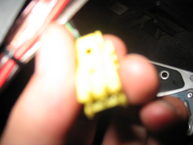

heres some pix of the little plug. Its the far most left yellow plug with two wires one of them being green. Push top of the plug and pull, not that hard.
I managed to do this successfully, but after the two blinks, the srs light stays on.... I dont know what to do now because this didnt work for me.
