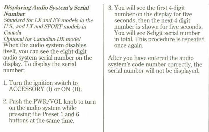

Originally Posted by EX4Dr
You can ask your dealer for the code. However, you'll need the radio serial number before they can look up your code. You'll also need some documents (repair receipts, invoice, insurance paper, ...etc.) to prove that you've had this car for awhile and not look like it's been stolen. To get to the serial number, you'll mostly like need to remove the radio from the dash. Good luck!
You absolutely DO NOT need to remove the radio to obtain the serial code. Also the code sticker is not placed in any particular location on the vehicles. It is up to the dealer and the person doing the pre-delivery inspection whether or not to put a code sticker inside the vehicle somewhere. See attachment for how to obtain your radio serial number when it displays CODE.
THat is some good ish right there. Ill will have to remember that, cus i want to change my battery next week.
I guess these new cars have the S/N displayed on the radio. I'd not had the opportunity to use my radio code on my Civic. However, Hondas in the 90's did not display the S/N. One usually would need to take the radio out to look in the back to see the S/N. Well, I guess I'm too old to be up to date on these things.
