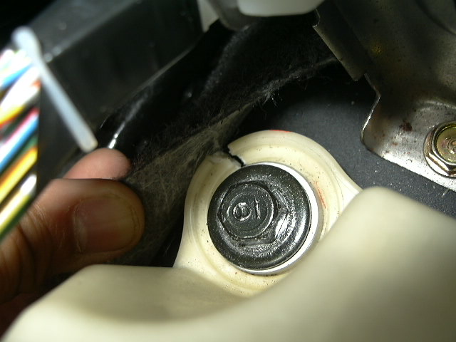

as grey said, it's freakin hard to take out the bolt............and yes indeed....i got three of em out.....however.....................the fourth bolt, the upper right side.......was so freakin damn hard that i need to use a lot of power...........and suddenly, *crack*...............f**k!!! the freakin bolt broke! 2 cm still on the chassis!!!
ok........*calm*..............i jacked up the car........look from the bottom, there was 1 cm left....i tried to unscrew em after pouring some liquid wrench and WD-40.....NO GOOD.....
the next 2 days, i went to my mechanic, he jacked up the car....flame torch the nut.....and succesfully unscrew the bolt from the bottom of the car.....
however, the thread in the nut is now "busted".....
the f**king next thing is that....when i tried to tighten up the bolt + CapYoda's bushing at 16 ft/lb like Cap and grey said, I BROKE THE DAMN SHIFTER ASSEMBLY!!
anybody ever experience this kind of things???

16 ft/lbs is too much for the new bushing...............it'll crack the damn shifter...

well2.....the first thre bolts were fine......it was only the fourth one, which is located on the right upper side....somehow, it's rusted soooo badly.......
i bought one bolt from home depot, 8x1.25x40mm and succesfully thread that nut again....however, it shaved down the new bolt too...
anyway, the bolt's fine....now what i hate is about that crack.....................
