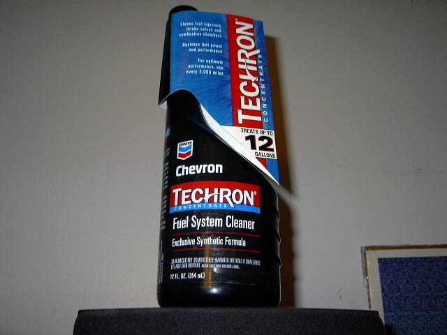

zen_master's Avatar
Posts: 3,784
chevron techron....
