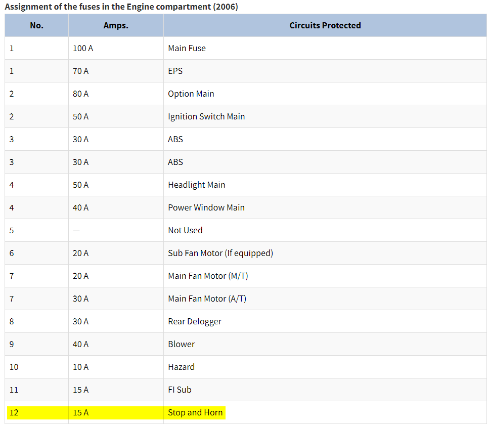

Not sure if this generation civic is like this but the fuse for the 7th gen that powers the horn also powers the rear brake lights. I’d see if your rear brake light is working.
Old Dec 12, 2023
Rep Power: 513
Re: Horn doesn't work.
looks like it does. It's fuse 12 in the engine bay
