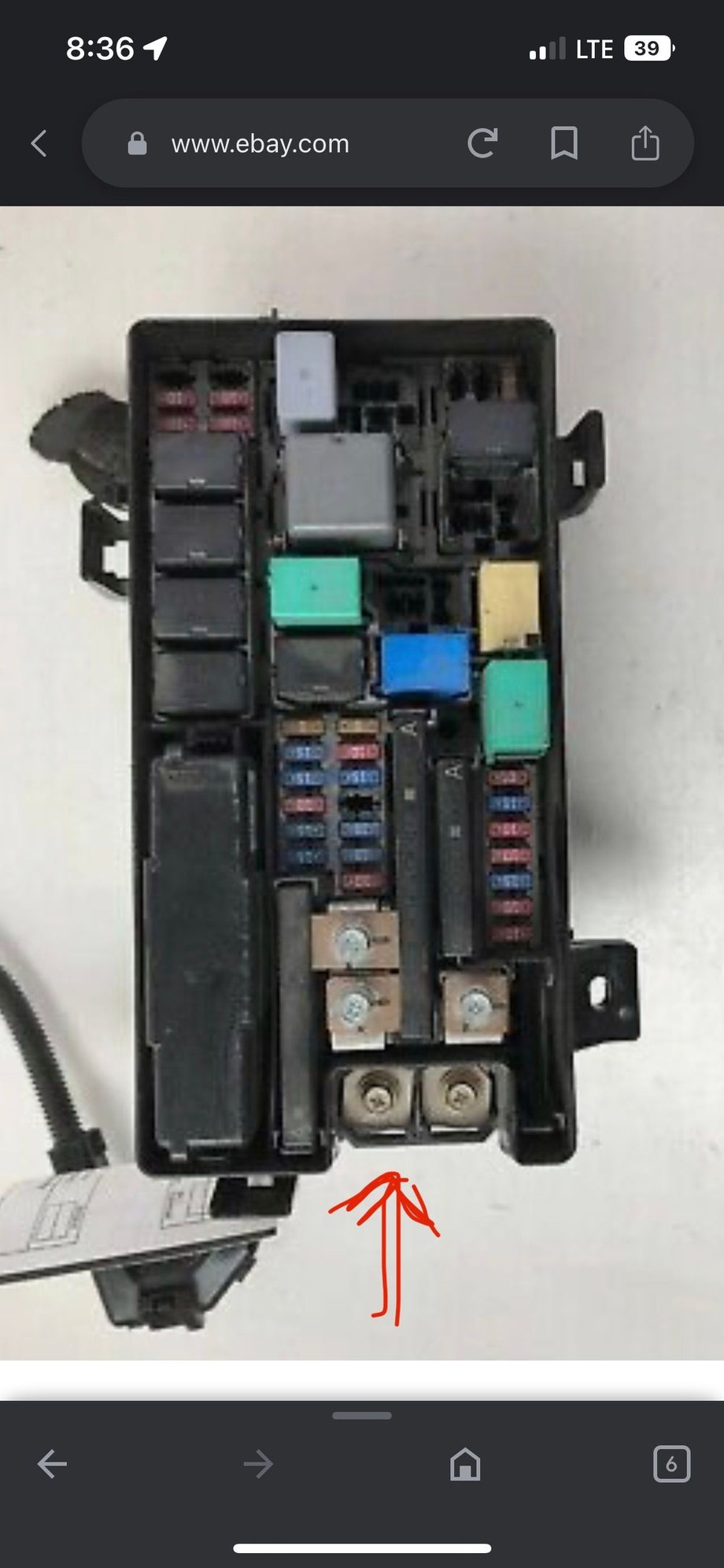

so when I looked under the hood today it looked like it’s connected to that fuse box thingy.. like it’s underneath one of the screws that’s connected to the fuse box if that makes sense. I think that’s what it’s called at least

I'd be worried if the amp remote wire was hooked directly to the "always hot" wires on the engine bay fuse box. I'd be willing to bet that's the amp power wire.
The remote wire would typically be blue with a white stripe, and should only be connected to something that has power when the car is in at least accessory mode. That way, the amp won't draw power when the car is off. If the remote wire was hooked up to an always hot wire, yeah, a switch would help alleviate that, but you'd have to make it habit to turn it on and turn it off when you turn the car on/off

It’s a thick red wire and it’s connected right there on that screw thingy
If I don’t do the toggle switch I wonder if I can just figure out somewhere else to put it? I have no idea what’s considered not “always hot” so I’ll have to look further into it
