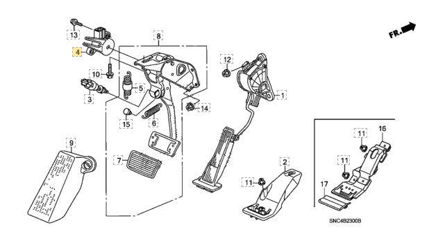

Brake pedal sensor, that being the small sensor on the brake pedal itself. Am I right? Thanks

See below for the diagram (item #4). Could be a faulty sensor or some issue with the wiring. I don't have schematics for the hybrid.
