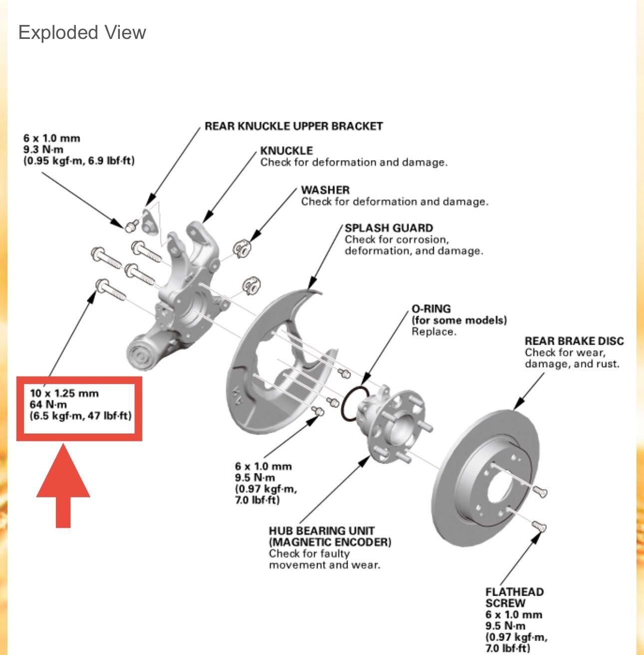

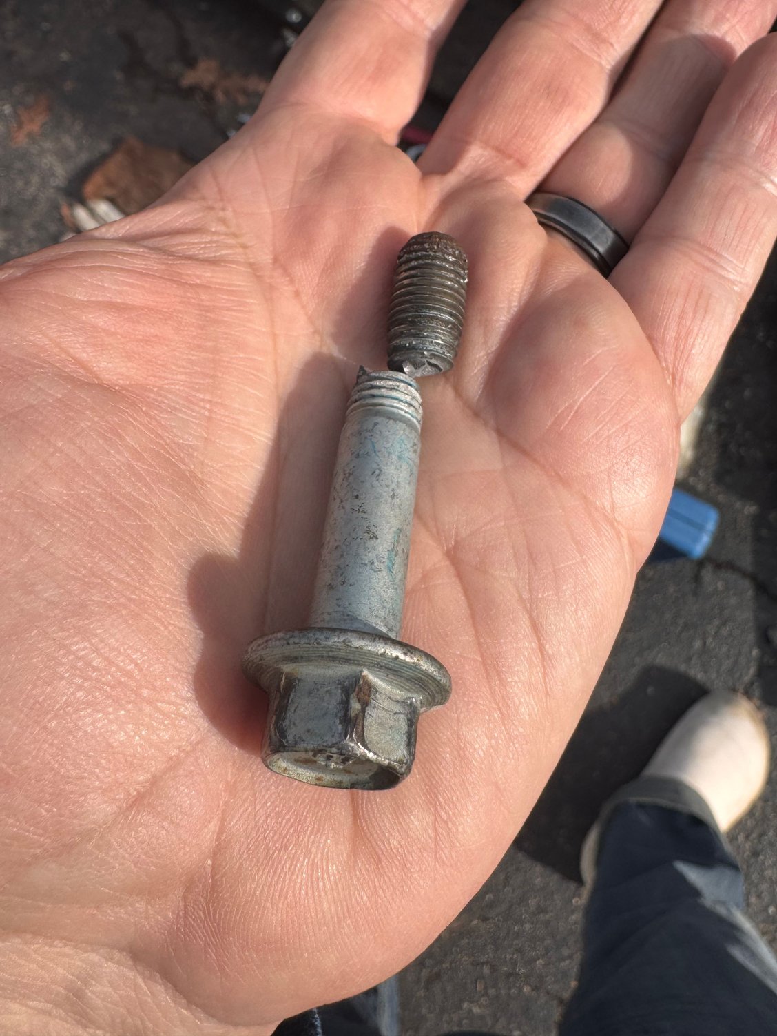

In the course of replacing my rear hub assemblies, I used the wrong torque specification and broke one of the bolts that secures the hub assembly to the knuckle. The shop manual identifies the bolts as “10 x 1.25 mm”. They seem to be M10 x 1.25 x 50mm. I cannot find this bolt as a Honda part number. Does anyone have the part number? I’ve checked all of the parts diagrams that I can find.
The bolt I need
The bolt I need
The broken bolt
The broken bolt

Found it. I'll leave it here in case anyone else has as much difficulty finding it.
BOLT, FLANGE (10X53) Part# 90163-SNA-000
