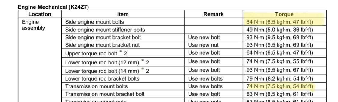

So in replacing my transmission mount, I need to know if I’m interpreting this torque chart correctly. So basically the attachments to the side of the car (#13 in the pic) are 47 lbf ft and the bolt into the transmission and the nuts are (#11 and #16, respectively) are 54 lbf ft? Thanks in advance!

That sounds about right. You can tighten it a bit more if you want.

So I installed the right front passenger side mount and it removed most vibrations. When my car was cold and put in reverse, however, I still got some rumble (not as bad as it was but still there….).
So, I installed this transmission one (54 lbf ft and 61 lbf ft). Pretty sure the original was still good though but I was already that far in so I figured I’d just replace it….I still have a rumble when cold. Goes away after driving the car for a while.
any thoughts on what to do? Do I replace the lower torque mount? I don’t want to keep throwing money at it but I don’t want that rumble in reverse either.
