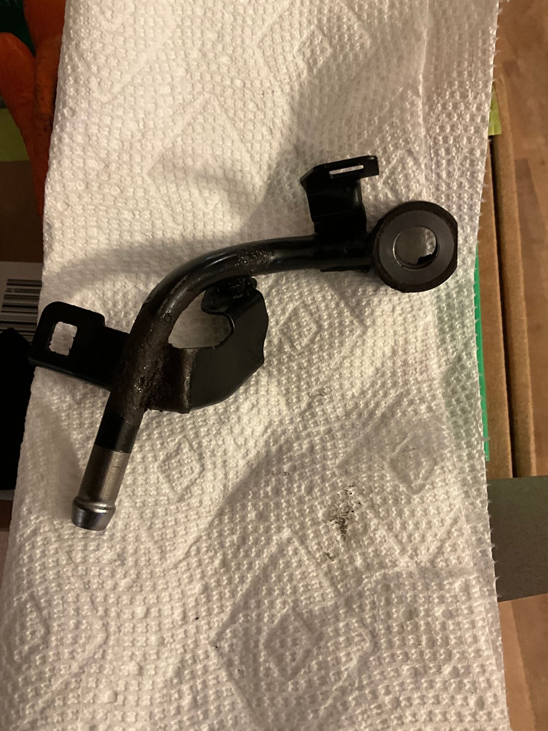

Hey everyone. My 2008 Civic sprung a leak from an oil line. It is a hard line with a banjo fitting that bolts into the front of the engine. The steel fitting goes into a rubber hose. I need help identifying the part so I can order it. Thanks!

What you're showing is a line for the transmission fluid cooler (carrying ATF). Part number is 25910-RPC-000.

That’s it! Awesome, thank you so much!
