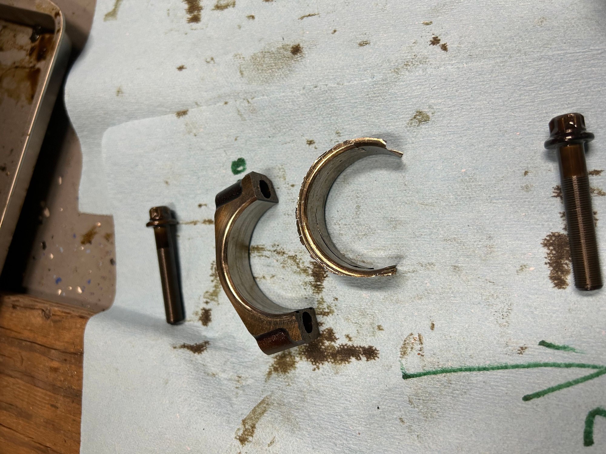

So I bought a 2012 Si coupe(manual) and it was making a whole lot of racket and throwing a P2646 code. Turns out it was rod knock. Cylinder 2 bearing spun
I bought replacement rod bearings. Installed them along with water pump, thermostat, idler pulley, belt, spark plugs, VTEC spool valve, misc. Orings got everything back together and now it's making this ticking noise.
Problems I noticed is
1. The car also does feel sluggish under acceleration
2. Rpm fluctuating at start up( which I'm guessing I need to do the idle learn procedure)
3. The ticking noise, seems more audible under load and gets faster with RPM
Could it need valve adjustment? Or VTC actuator? No CEL or codes being thrown
https://youtube.com/shorts/v8ko0bjYkKk?si=TWJKKXbRVAItLsEh
https://youtu.be/uC-_Uo0noo0?si=9FKVTRIrKifRFzVu
Pic of spun bearing

Could just need a valve adjustment. But more likely when it ate the bearing it sent a bunch of crap through the oil system and damaged other components.

I did a pretty decent job of cleaning all the scrap from the oil pan, oil pump and checked for cylinder scoring and inspected the head for any trash. so im hoping not. The pistons dont seem to have any play on them
Cylinder 2 had a little scoring but nothing drastic. Ill take a look at the valves next.
