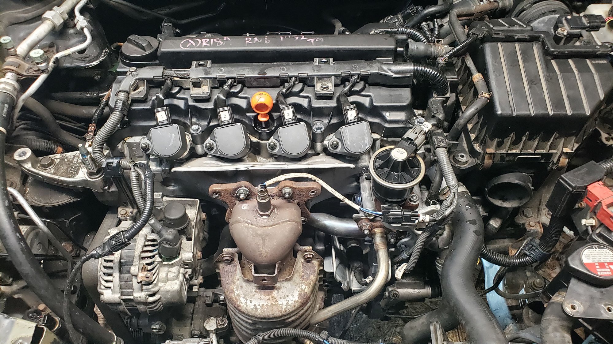

Hey all,
Just swapped a badly overheated engine with a JDM engine that I was told ran when pulled. I've gone through and connected up everything on the engine, the image below is where I am at. Just using plain DI water for now in the coolant and new oil + filter as well.

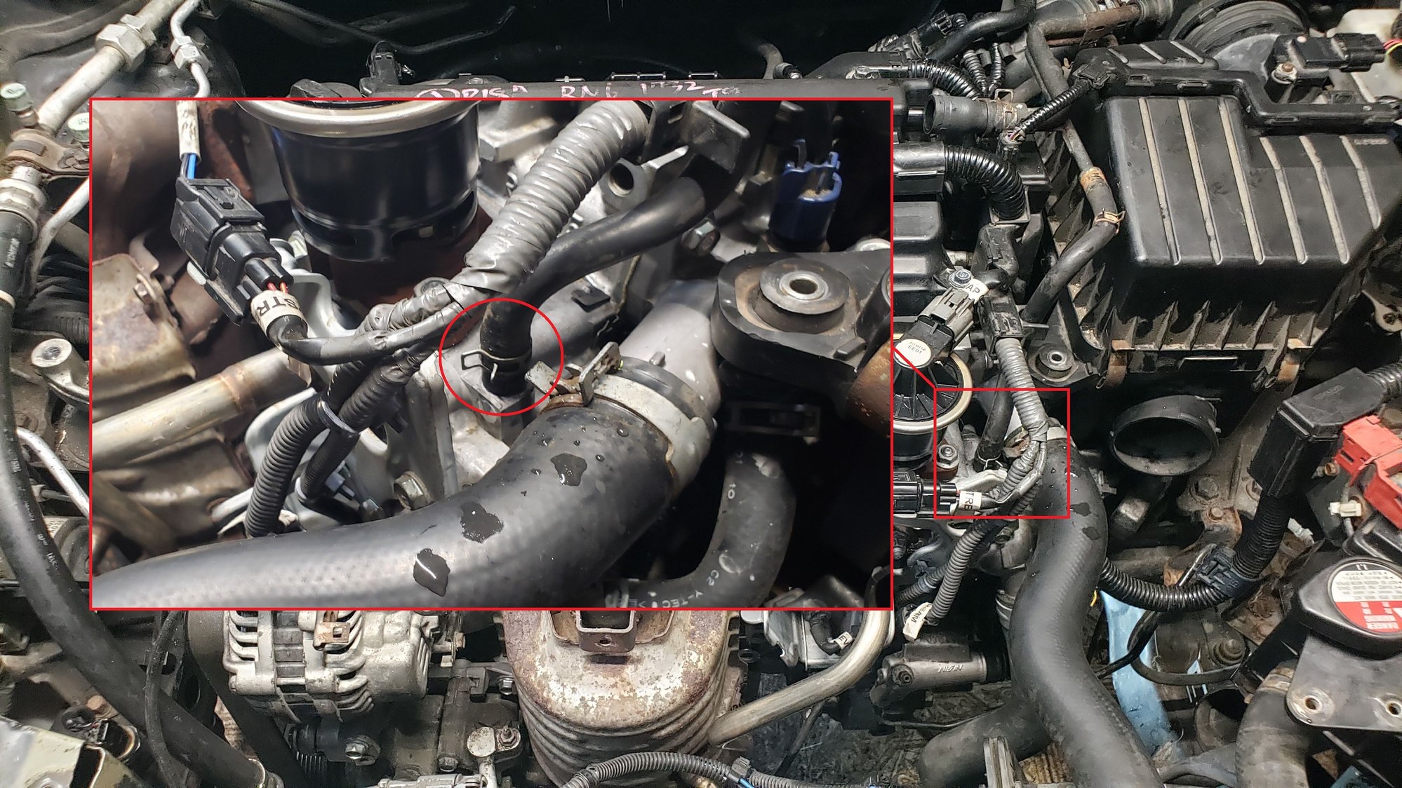

When I got everything configured I stared the engine up, she idled for a half second and then dropped below 400 rpm and died. I attempted a couple more times with a little bit of throttle and could hold her at ~1500 rpm with the idle dipping about 100 rpm every second or so (Rough idle), every time once I released the throttle it would die the same way as the first. One thing I did notice was a pretty big white cloud while running it which made me think head gasket. I did my own test to make sure and all cylinders had pretty good compression between 155-160 psig, so I doubt it could be that but let me know I yall disagree. I was about to disassemble to investigate further and when pulling the vacuum line pictured below coolant came pouring out of the stem until I put the line back on.
I don't know if I routed something incorrectly or this points towards a component being failed internally but I can see this explaining the white smoke in the exhaust. Are there any further investigation or root causes you guys can think of? I don't wanna push anything cause that vacuum line also manifolds to the top of the valve cover meaning I could be shooting coolant into that as well.

That is a coolant line, not a vacuum line. It runs to the throttle body.
Any fault codes?

No fault codes, I originally had some on the throttle body cause it came with the JDM engine but when I swapped it to the original engines throttle body the codes went away.
