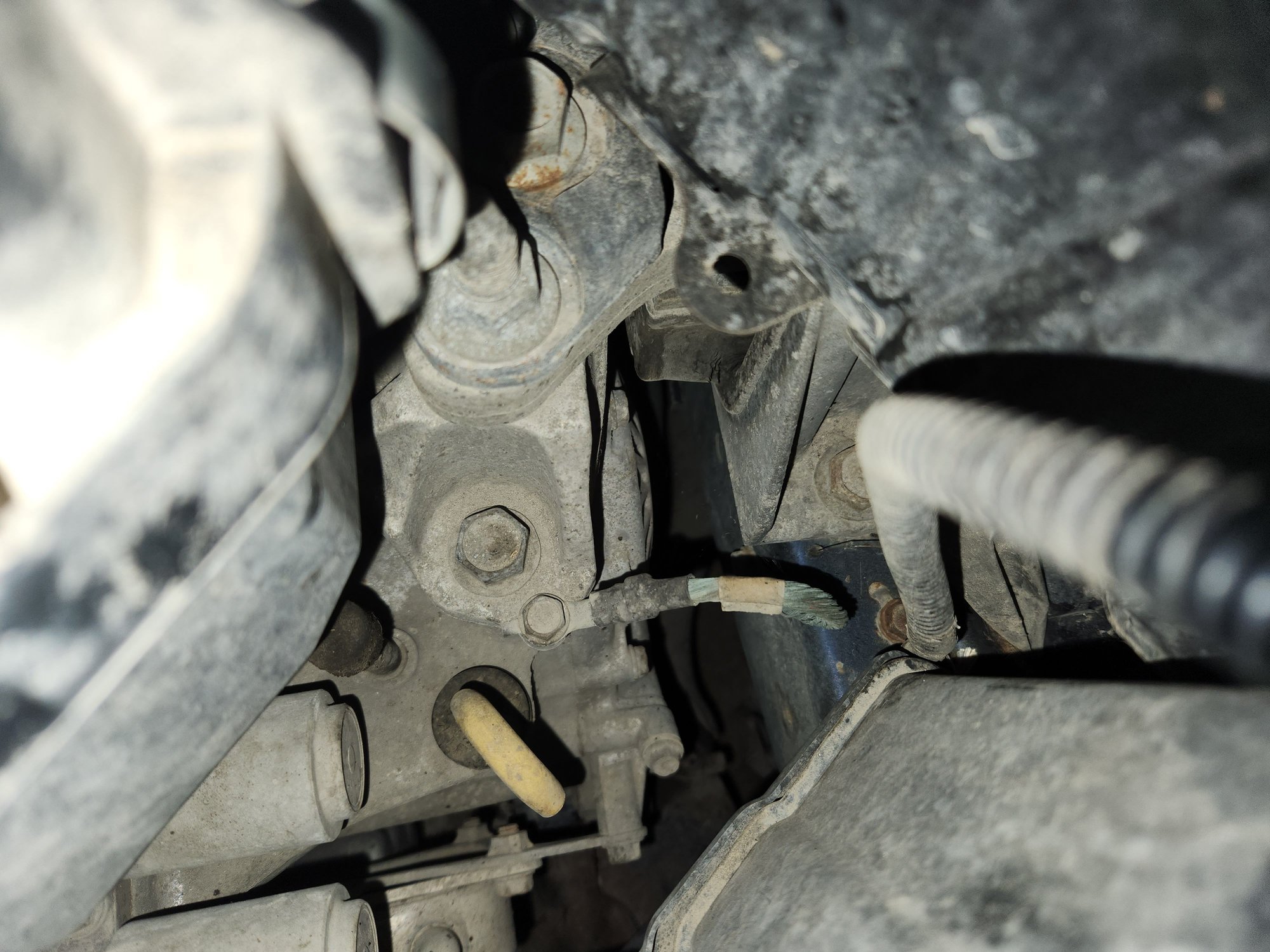

The battery connections appear fine(and are plenty tight). The chassis ground behind the battery appears to be fine(cell phone images attached for your analysis). I do not know the location of any other grounds to check - image searching bring up almost entirely images of modded engines, so it is less than helpful. Could really use a clear resource on this.

The one on the trans looks pretty green, as long as it isn't crispy it should be ok
