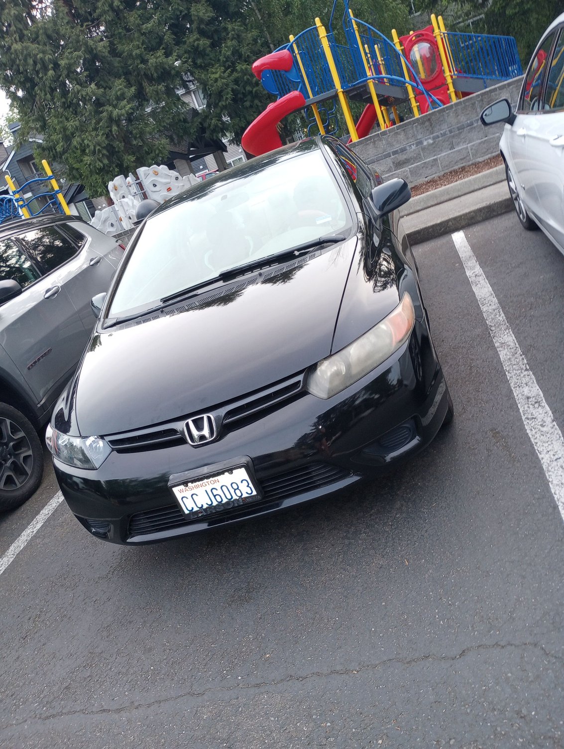

First post, normally I scan through to find my answers, unfortunately the issue at hand has become a little specific. This car was given to me 2-3 months ago. A little over 160,000 miles and owned by someone who just did not maintain it properly. I was raised by a mechanic fortunately. First problem was my a/c compressor pulley bearings and purge valve solenoid. Being a single mom, in Washington, to save money and no need for a/c often I decided to just bypass the compressor all together with standard belt size. I did check all pulleys with the belt off using a stethoscope. Once I got a closer look I saw the passenger side motor mount had collapsed (only drove the car home at this point) so I decided to go ahead and replace all mounts. No big deal. Got the new belt on. And yet another noise. Which I found to be the tensioner pulley. With a car this old and miles, of course, I replaced my tensioner. Also found oil in 2 of my coil pack/ spark plug wells (on the top end, not around the threads of the plugs) but it wasn't much. Replaced spark plugs and coil packs with OEM products. As well as my valve cover gasket, and then also power steering fluid. Oil and transmission fluids seemed to be in good condition and at correct levels. After all of this. I find a what I would call a click coming from engine. Did some online searching before going back in I think it needs a valve adjustment. I drove it last night possibly a little further than seemed suitable. But it threw a code and the ticking is now faster. I don't have an obd myself or a feeler gauge. The parts store is a mile away. After online searching videos and everything. I'm scared the timing belt was the original problem. . . . . The car starts. And will drive. Am I okay to take it a mile and back. Do I bite the bullet and walk? Any tips would be greatly appreciate. Sorry for the novel.
