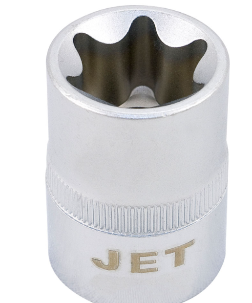

Originally Posted by Ace J Timmons
Could you tell me a complete list of the tools I will need
To do a complete tear down? A lot of them. You sure you have the skills to do this?
and most importantly the size of the bolts holding the bearings in the rods?
I believe the rod bolts on this engine use the reverse Torx, size would be E14.

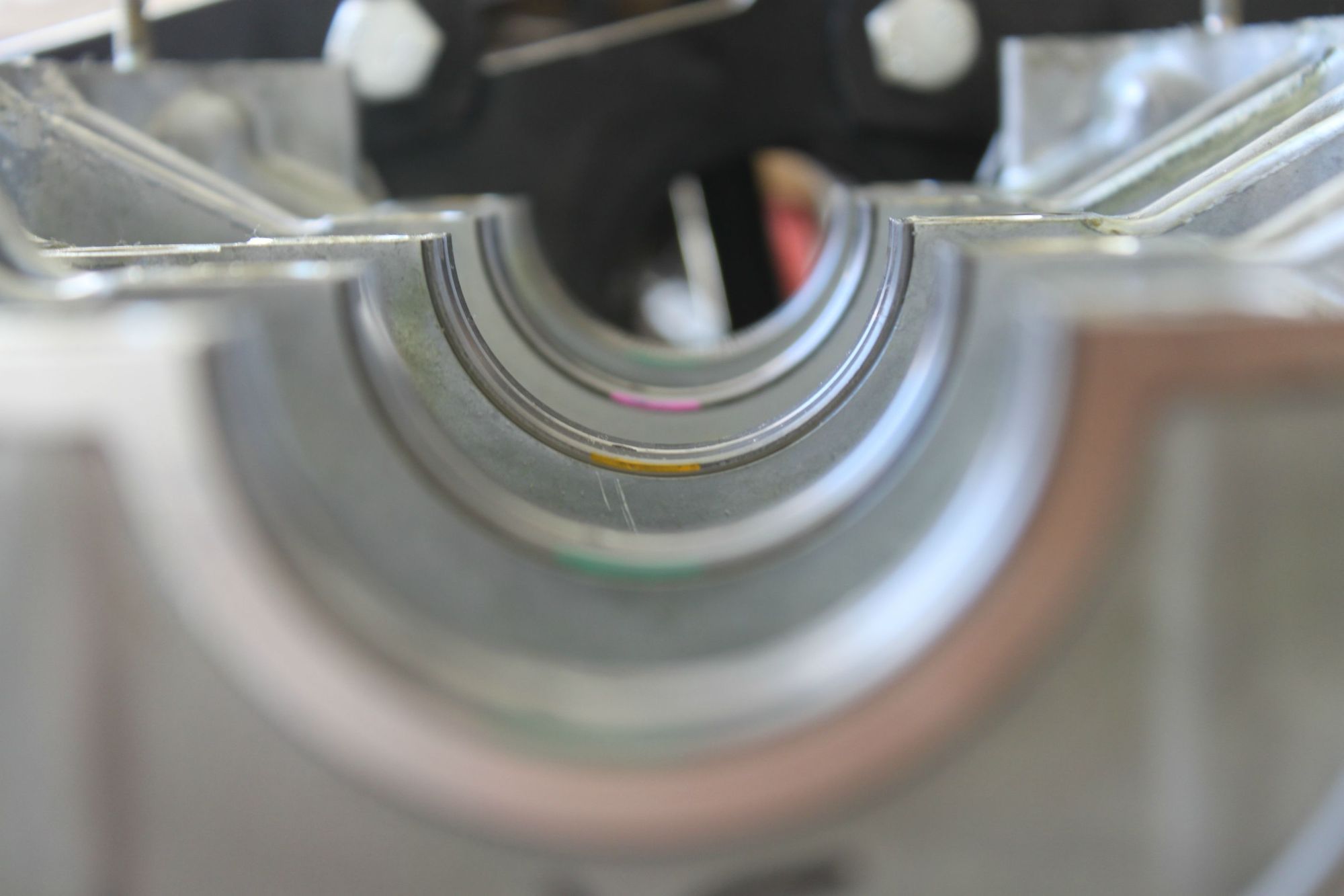

can I not use the codes on the engine block to find the right color of bearings
Those codes on the block are for the crankshaft main bearings. For the connecting rod bearings there is a code on each rod and another on the crank next to each rod journal.

Not an 8th gen si, but here's how I saw the bearing colors for the D17A2 I took apart. Luckily I didn't have to change out bearings, but I still plastigauged it to make sure clearances were in spec.
