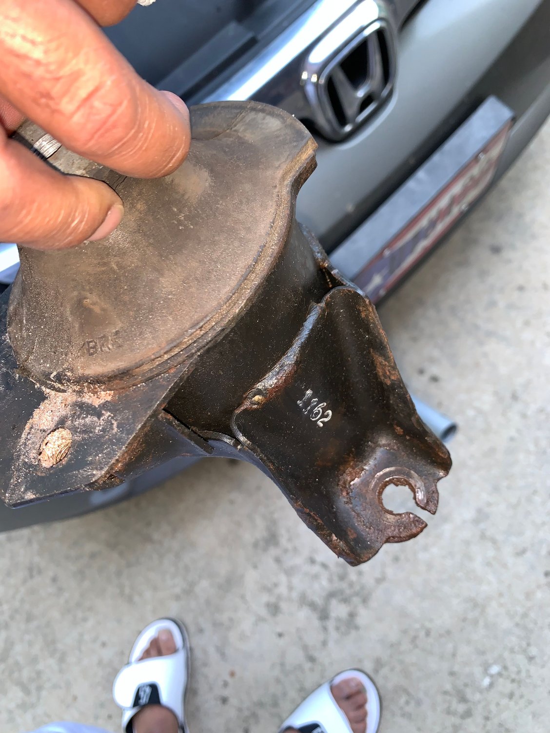

Hello my friends, I need help for my 07 Honda Civic EX ,, I am replacing the front top passenger side motor mount. The main 2 motor mount bolts one of them does not look good and I wana replace both of them. They are 17mm head(flanged)… I called the Honda dealership closest to me and they said these bolts are in BACKORDER, and no time frame when they can get em.. I believe these bolts are M12 1.25… I been to every part store closest to me and the don’t have anything that even looks like these bolts.. What I am asking is if anyone knows of where I can order or buy these bolts, please send me a link please.. I’ll post some pictures to show how one of the bolts doesn’t look too good… thanks in advance

95% sure it's P/N 95701-12040-08. Here's a link for them, and if you're worried about being on backorder, I'd e-mail them. Otherwise, it's an M12 bolt, 40mm length (I'm willing to bet they're M12x1.5-40). If you have a pep boys around you, see if there's anything there with those specs. The one near me has a pretty extensive fastener selection.

Can also hit a junkyard, should be able to find a newer less rusty civic with the same bolts
