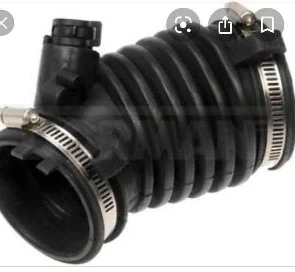

I had same issues on 2015 civic, it was due to a crack in the rubber intake boot. Unable to see crack until the boot was squeezed, which was affecting air/fuel ratio. No more hesitation, car runs really smooth and quiet
My hesitation when pressing gas was due to a crack in this part, intake boot.
