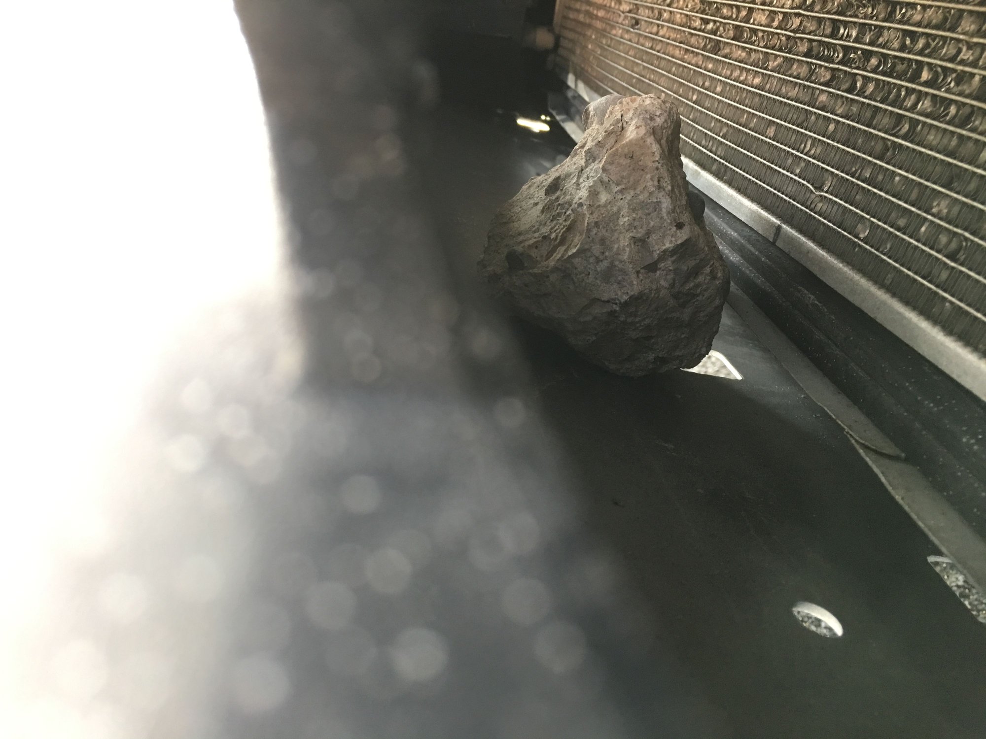

Hi All,
My first post for my 2012, love my car, Honda builds great vehicles (from my perspective ). They don't, however, build ones to take an impact from a chunk of concrete traveling at 100+ km/h (see pics), though I'm sure someone has modded one to .
Anyway, 2012 Civic Coupe EX @ 185,000 km. I am changing the condenser and rad.
- I know my '05 had a separate dryer for the refrigerant, does the 2012 as well? Someone said it is attached to the condenser?
- Any DIY articles about recharging a completely empty system? (I couldn't find any in the DIY section?)
- Anything else I should buy other than the actual damaged components? (I'd like to keep it low budget, my rad hoses and other items seem to be in good shape)
- Anything else I should know? Links are welcome, I don't mind reading.
Thanks all.

ouch, that's a big chunk for a little car
if you don't have a set of manifold gauges and a vacuum pump just have a shop recharge the system.
not sure if the drier is separate, try checking parts websites

Dozer blade, plow blade, skidsteer blade or bucket....cow catcher. Check ecomodder forums, the cow catcher might be a little more aerodynamic
Drier-----is a replaceable tube attached to one end of the condenser. New condenser from Honda comes with a new one, but IDK about aftermarket.
During component replacement some PAG oil must be replenished, the FSM has a chart that tells how much to add when various components are replaced.
I would also calculate (wildass guess) how much oil would have likely been lost as a result of the puncture and subsequent rapid release of freon and oil, and add that as well.
Replace the O ring on every fitting you touch
Professional evacuate and charge by weight (though use of aftermarket condenser could cause ideal charge weight to differ from stock)
