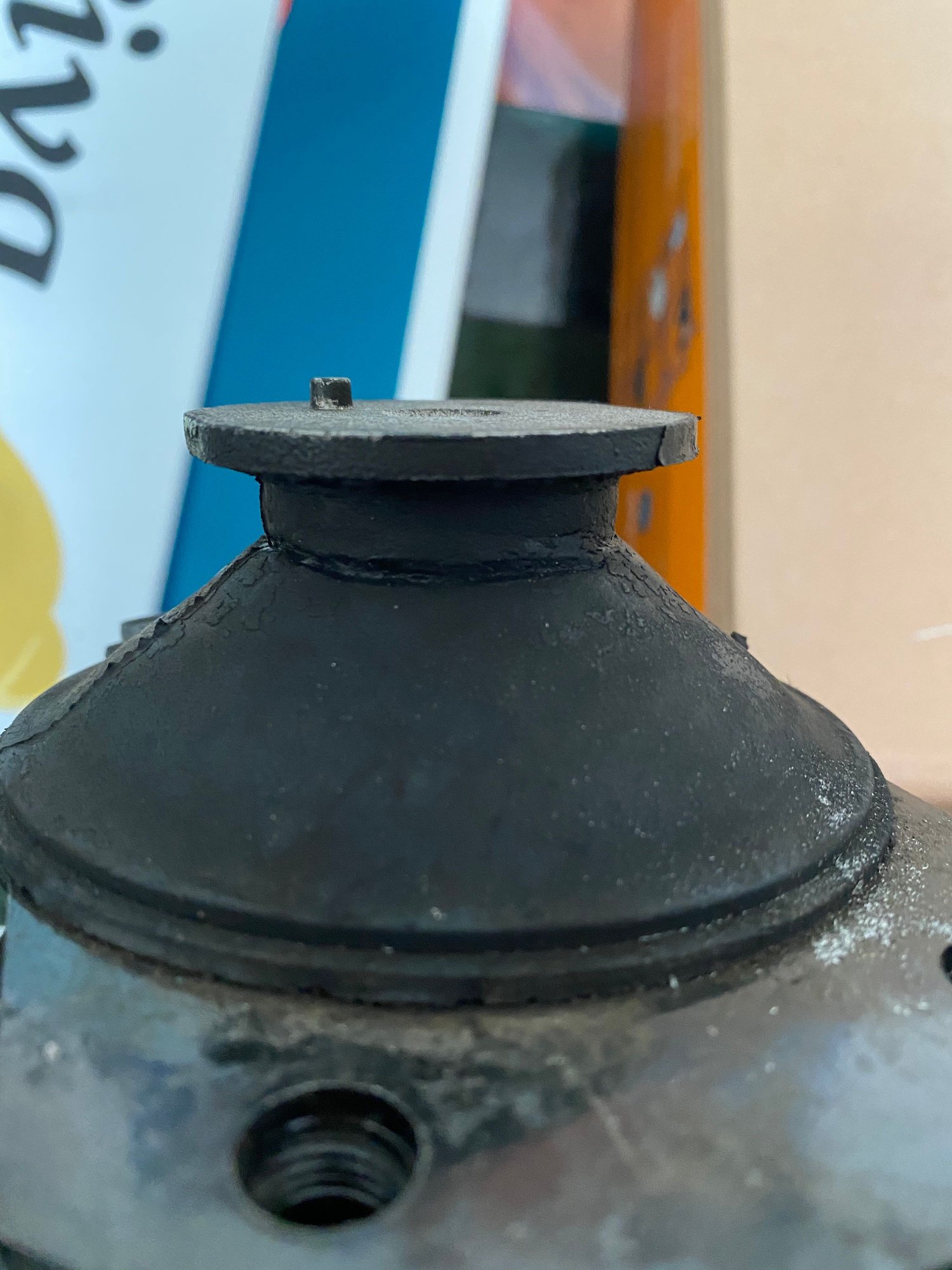

2009 Civic. I've replaced all the mounts about 2 years ago. A year later the motor mount was replaced again. Here I am once again a year later and the motor mount needs replacement again. What could be causing this? Could I have bought 2 defective mounts?

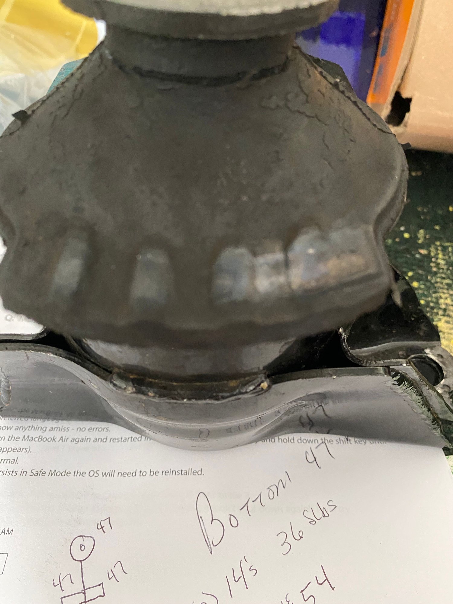

Im not buying the OEM part problem. This shouldn't be happening. There is something causing undue pressure on this mount making it collapse. The bracket attached to the motor drops and contacts the mount causing the vibration. The car run fine. No vibration in the steering. Its great on the highway doing 80+ MPH. No vibration until the mount goes out. I think if I put in an OEM part it will still go out.

I've never owned an 8th or 9th gen Civic and do not know if that Honda original mount is a hydraulic (fluid filled) or a solid rubber mount. I have used Anchor brand solid mounts on a couple 6th gens and other than increased vibrations for the first three months after replacement they held up for 3+; years until I sold those cars.
I purchased those 6th gen Anchor mounts over five years ago and I have read that their quality has worsened in the past few years. Others having issues with them only lasting a year or less (on various vehicles). Also, if the solid rubber Anchor mount you purchased replaced a (factory) hydraulic mount the vibrations to the Anchor solid mount would certainly increase and that force could sheer it if it is made up of inferior rubber compounds (which, it most likely is compared to Honda Genuine).
One option is to either buy another Anchor mount, or perhaps use the torn mount and fill the middle gap in with 3M Window Weld. If you choose that option once you fill in the gap with window weld submerse the mount entirely in a bucket of water until it dries completely (about 2 or 3 days) before installing.
