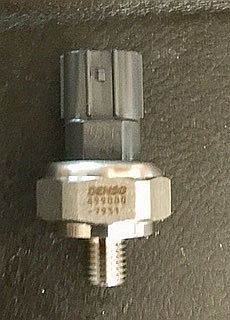

I tried for an hour or so to figure out how to replace this sensor (not switch). It was REALLY buried. I tried from the top and from the bottom (on ground, not a lift). I finally gave up and enlisted the help of my friendly (and very small handed) European auto mechanic. It took him about an hour but was successful. One of the things he did was remove the adjacent bracket which he said gave him a bit more "breathing" room. And I am happy to report that it resolved the issue. Cruise control is functional again as well. I found the sensor on Amazon for about $30. Genuine? Knock off? Who knows how long it will last....
Oil pressure SENSOR Oil pressure SENSOR
I hope this post helps others.
