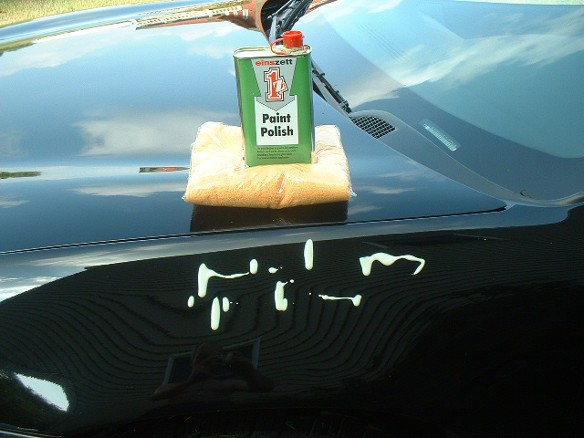

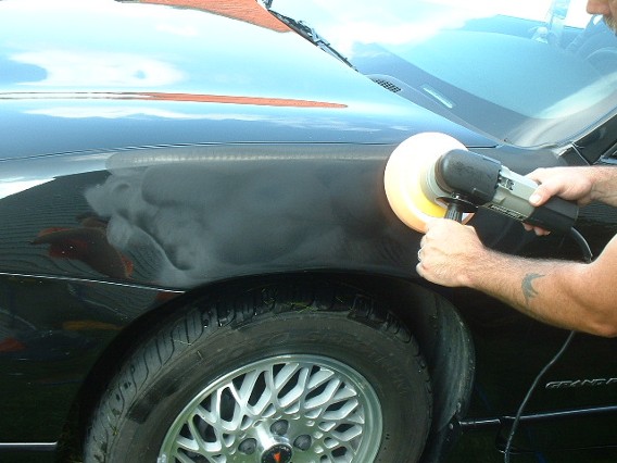

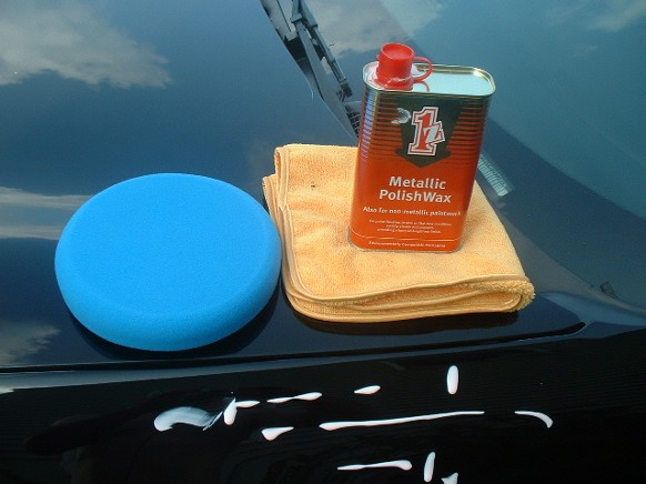

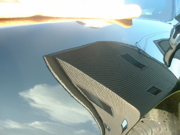

PC 7424 With Sonus Pads
I have two complete sets of the Lake County pads. They "where my favorites"
Now I use the Sonus Pads.
The Spider webs you are seeing are also called "Swirl Marks". they are very shallow scratches in the clear.You need to polish them out.
Here is a car I did that also had swirl marks.
The polish I used was 1Z Paint Polish then followed up with 1Z Metallic Polish. Menzerna is also a polish I use.

beautiful, very well done, that will help out a lot. Now what kind of pressure are you putting on the buffer, and what kind of buffer is that?

The only pressure I use, is the weight of the PC. I use a light touch but polish a little longer than most people. Say 5 minutes on one section. The less pressure you use the easier it is on the buffer,s bearings, the more the polish can work and the less mar marks you may get from pushing to hard. Plus if you push hard you sloww the buffer's orbits.

looks like you let one loose on your fender.....

I told you I was extremely happy with 1Z polishes.....

The black looks good !
