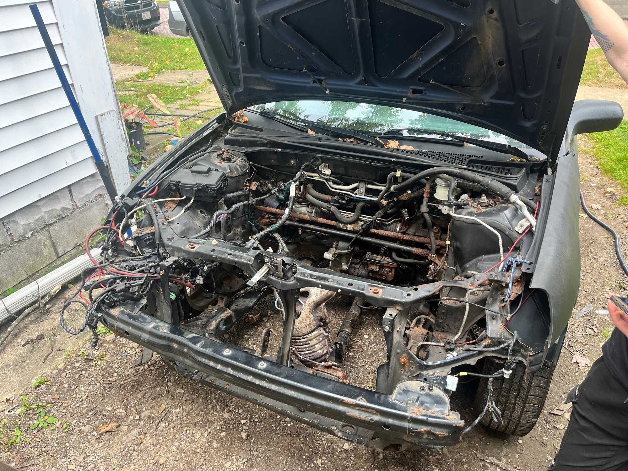

Okay, so, here's the rundown.

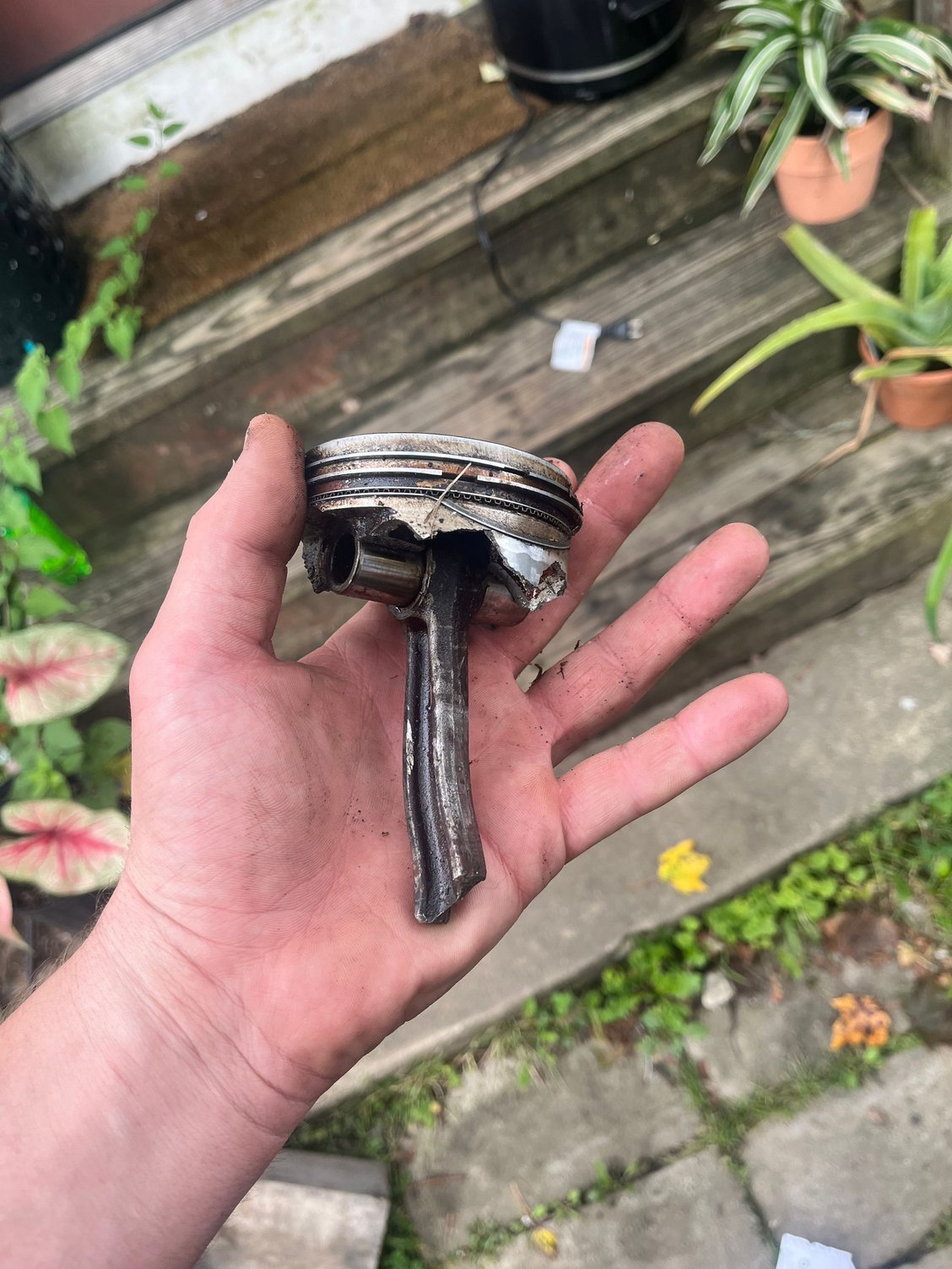

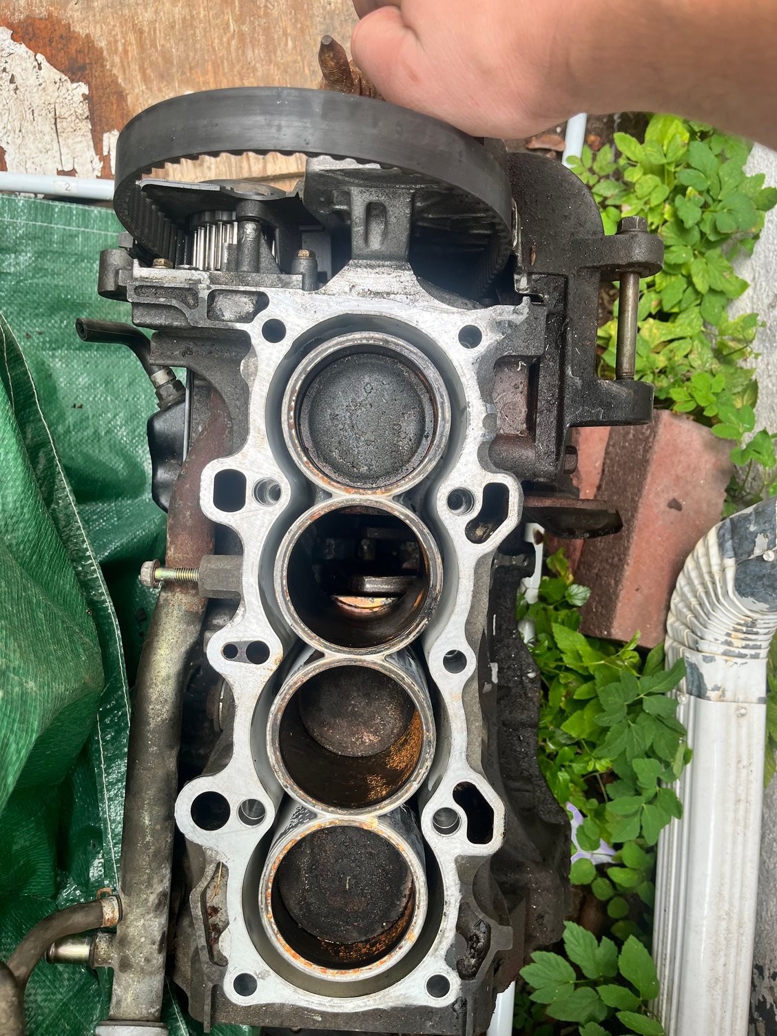

I've owned 2 civics in my life. one an 02 and one and 03. I've never done anything to either aside from oil changes. I have a mechanical background but I've seldom worked on imports. My partner has my original 03 civic now and a couple weeks ago sent a rod through the block. So, with judgment out the window, I decided it needed the D17A2 block instead of the A1 it has.
I've never done this and I'm starting to worry about it. so I'm leaving my comfort with you.
2003 Honda Civic, automatic, d17 A1 block.
I plan on keeping it auto, she cant drive manual well and doesn't really seem in a hurry to learn.
I bought a D17A2 block from a junkyard with 36k on it, pulled from a running car they still used to carry tools around the yard.
doesnt leak oil and the oil and coolant looked beautiful, sounded great. - $800
Bought a D17A2 wiring harness off of eBay for $250
also bought a computer with key and cylinder from an auto VTEC car. this was almost $400 but the closest honda dealer is 3+ hours from my house and it was cheeper then towing the car out there to have it done.
aside from this were also installing heavy duty cv axles, heavy brakes and slotted rotors, all new nickel brake line, new tie rods inner and outer, new brake line manifold ect. the whole front will be new pretty much. "I live in the rust belt and this car has survived here its whole life and somehow has no rust on it and I would like it to stay that way) so everything is going to be coated.
So what's the likelyness of me pulling this off. its to late to stop, already have the motor out, just put the trans on the new motor and I'm waiting for the new motor mounts in the mail so I can slap it in there. I would attach an image but my new computer only has USB c ports for some reason.

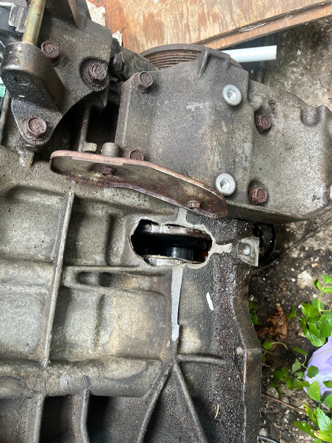

Re: OKAY!>Engine swap
Old Sep 3, 2024
BrotatoChip's Avatar
Super Moderator
Joined: Jun 2012
Posts: 5,073
Likes: 2,096
From: Ohio
Rep Power: 225
The new viewing port in the side of the block is pretty neat!
