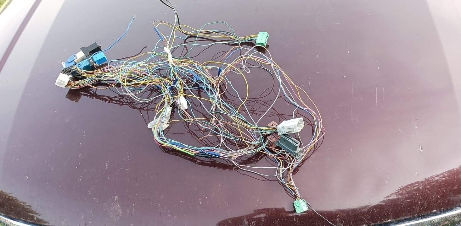

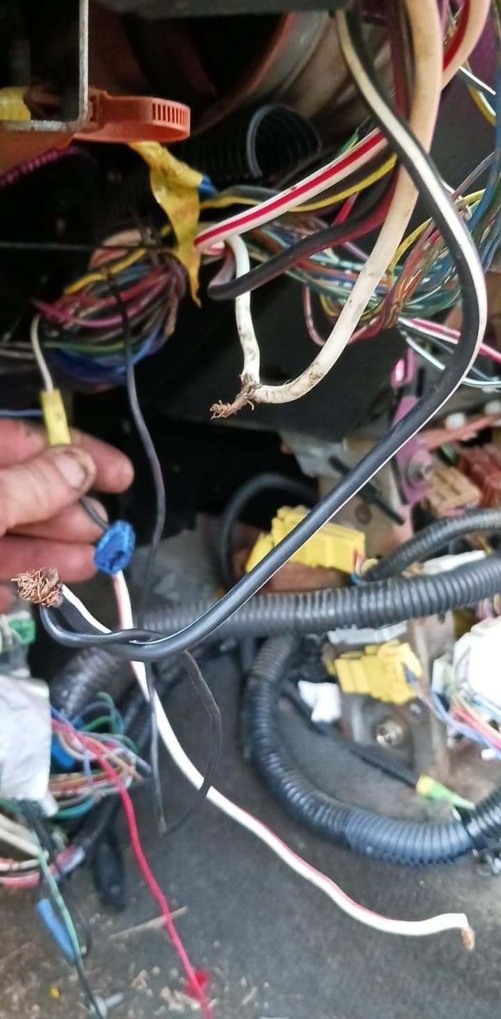

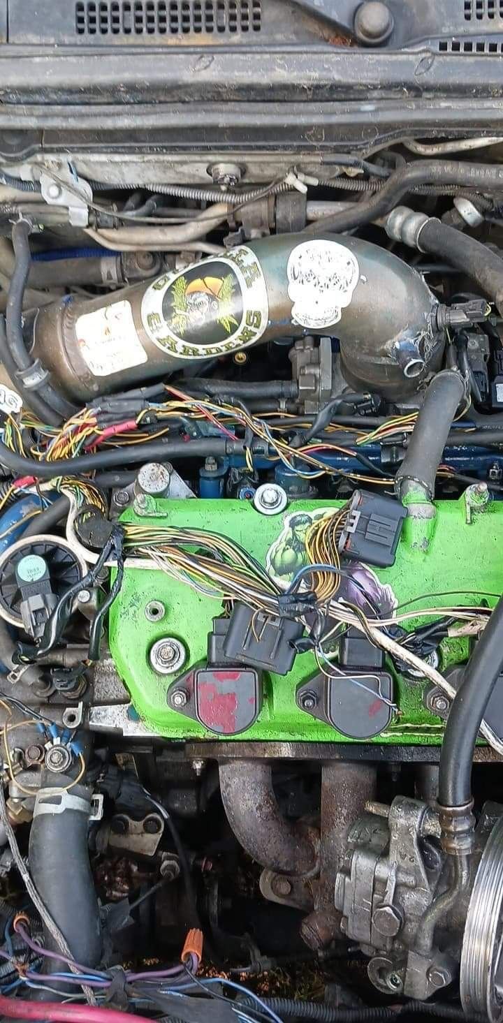

Hey yal im new to the group but i have been doing some reading an cant really seem to find a straight answer so i figured i post an see if someone can shoot me a straight lead. I have a 03 civic that i bought with alot of wiring issues due to swaping parts an not knowing what they were doing. I have replaced the ecu (manual) and i replaced the engine harness but i got a auto harness cause i couldnt find a manual. What do i need to do to get the auto harness to work with the manual ecu? I believe it has a manual gauge cluster in it already.

clarify this:
Trans: Manual? Auto?
ECU: Manual
Harness: Auto
