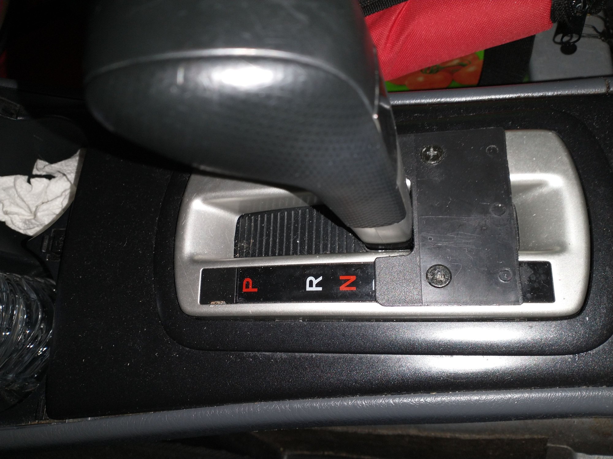

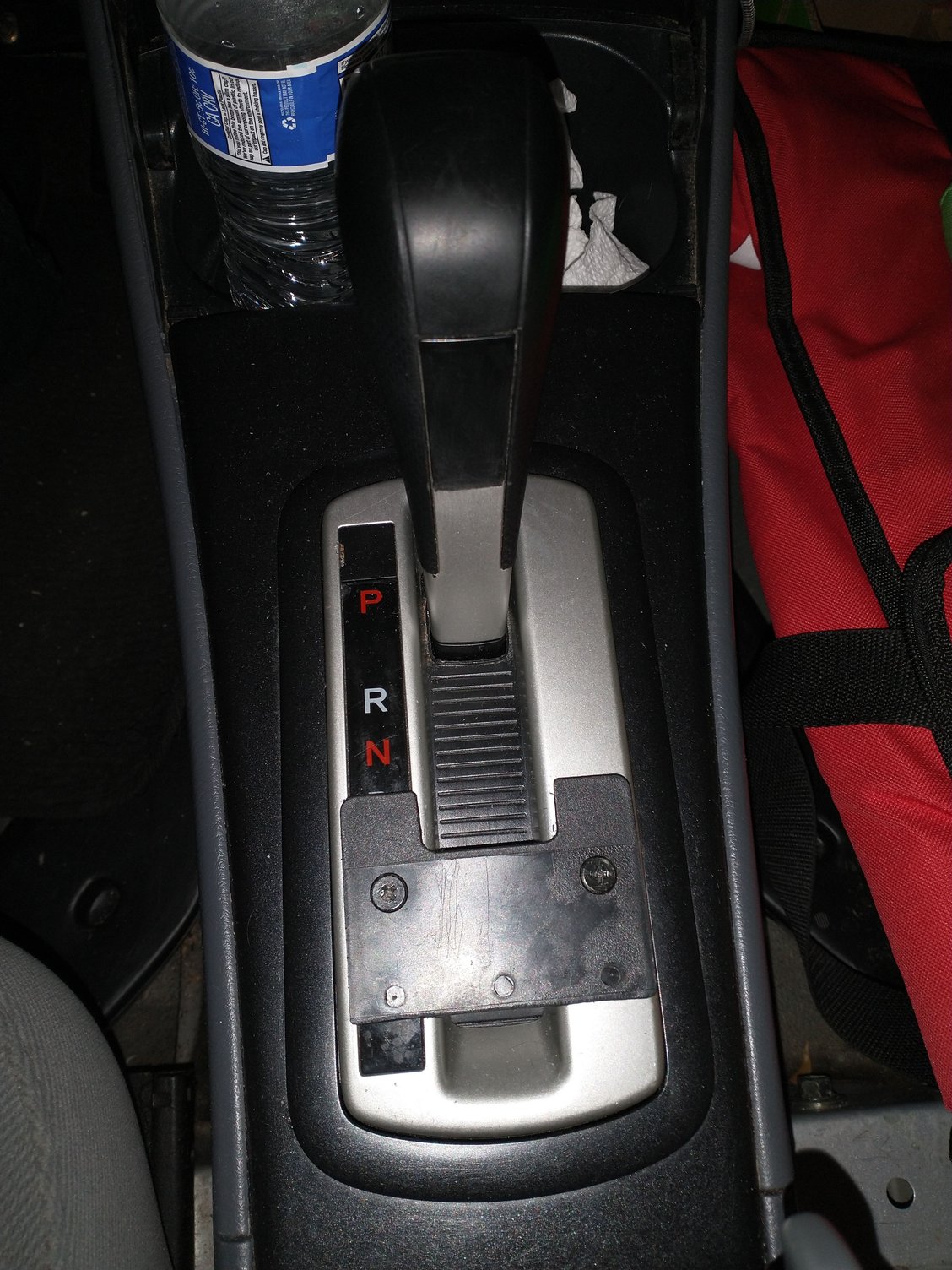

Perfect, you are in the right place. I will take a photo and upload to show you what I did with mine and is very simple. You need to add a stopper so it doesn't move down. Find the green light stays D and secure it with a stopper. I will up load what i did with a piece of plastic and 2 screws.

That's a cleaver solution. When I had a JDM auto I just put a piece of electrical tape across the base of the shifter where drive was so I could easily see where drive was until I got used to it and then took the tape off. If I remember correctly, drive was about half way between D and D3 on mine once I adjusted the cable but I swapped to a 5 speed almost a year ago so I don't remember for sure.
