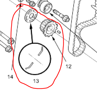

Previous owner failed to put this keystock in whenever they did whatever they did. No damage besides valve cover. Got a replacement for that arriving tomorrow
Anyways I'm putting the little guy in
do I put the sprocket all the way against the spacer between the sprocket and oil pump?
I assume yes. But just figured I'd ask the vets
Only reason I noticed this is because I had to replace that awesome little o ring on the oil pump (don't worry I didn't mess the timing up, I have the crankwheel locked in place and marked the belt and sprockets and pulleys before I removed anything)
Thanks in advance!

From the oil pump you have the timing belt guide plate thing, then the timing belt sprocket, the lower timing belt cover, then put in the key and install the crankshaft pulley.
cool. Makes perfect sense.
Thank you
