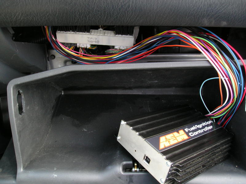

I'd like to see a picture of your unit... aha, you know what I mean. Whats your serial number? A link to photobucket will suffice.

TRIZ here is a picture... My unit doesn't have a serial number and I'm also using a prototype jumper harness that has the FIC harness wired into it so I didn't have to touch my factory harness at ALL!

Thanks for all of the updates FICivic!
