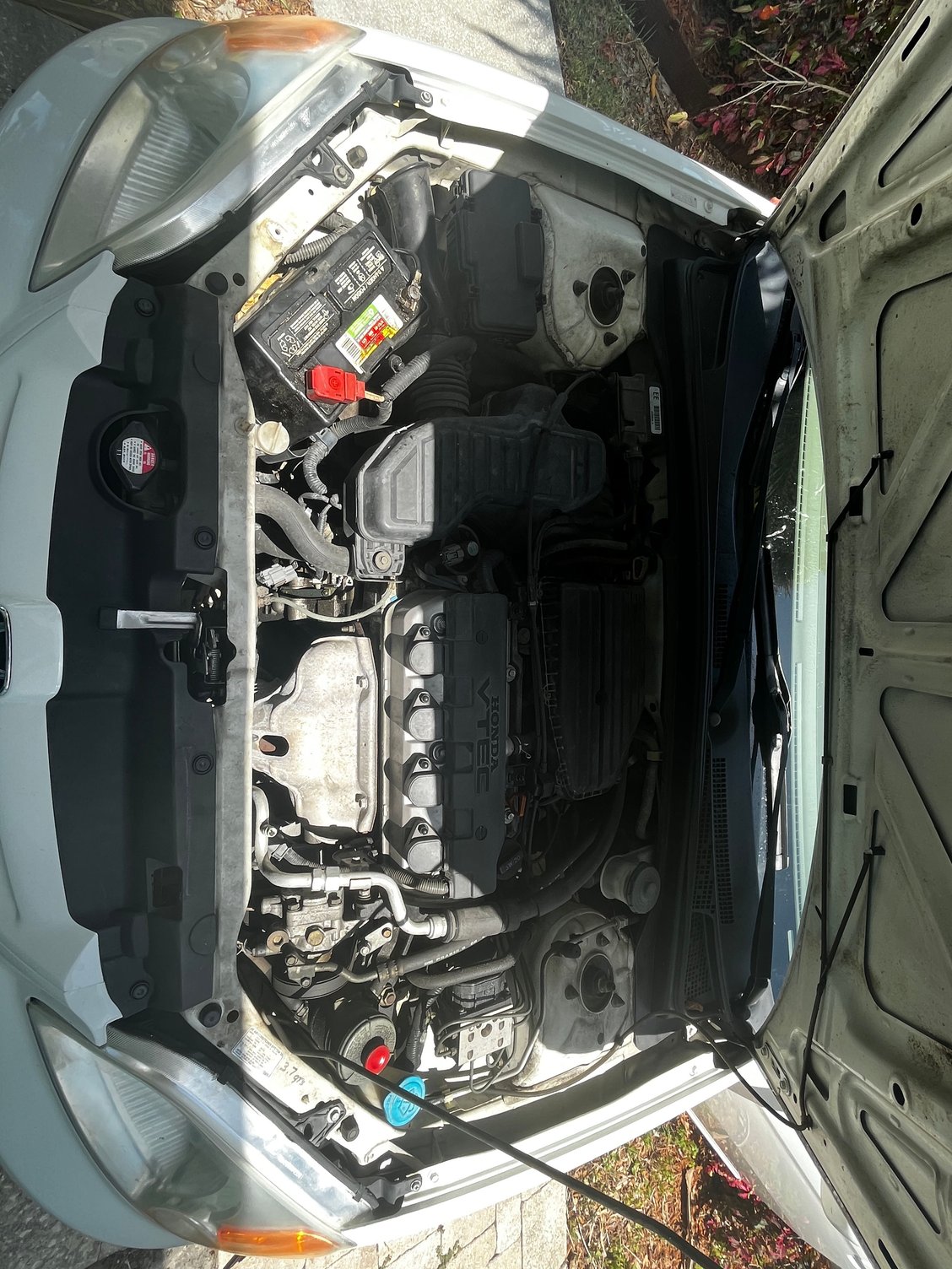

Below, I’ve dropped some pictures. What my car looks like and what the engine looks like stock.

It appears to be an auto (no clutch reservoir in the engine bay pic). Your options are limited. Manual swap your current car, sell and buy a manual version, K swap and keep auto (K20a3 from an RSX, maybe a K24a2 from a TSX), or make due with what you have.
