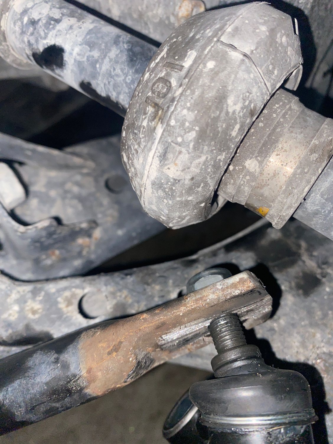

Sway bar link won't tighten
Okay but how do I get to the top passenger side one…. I’ve been workin on my civic all day got so much done but the final thing is getting these sway bar links tightened. I got them both in and the nut on but I can’t really get in there with a ratchet for the top one let alone a Allen key

Suspension loaded? I have the car on both sides lifted, both links are on an screwed in a little bit, I tightened the right side a little bit with a wrench holding the bolt and using a ratchet but I can’t tighten it anymore without the bolt spinning so I figure I Needa use a Allen, an a close end wrench to get it where it Needa be

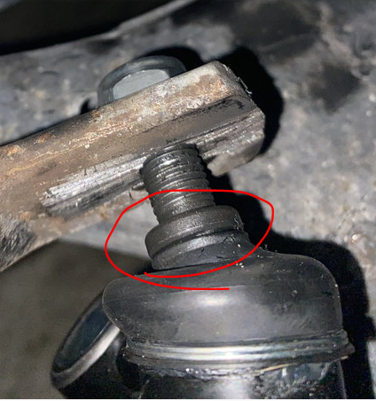

Re: Sway bar link won't tighten
If the red circled part below doesn't have two flat surfaces for a wrench, then you will have to use an allen wrench. Most aftermarket brands I've seen don't use an allen, but OEM does.
Also, if you take the link off the control arm side on both driver and passenger, you might be able to swing the way bar up or down giving more clearance. Put both links on the sway bar first and tighten before connecting to the control arms. I've never needed to do that but just a thought.

thanks man I ended up buyin a special wrench to be able to get in there an used an Allen key jus a lil bit of squirming around an finally got it
