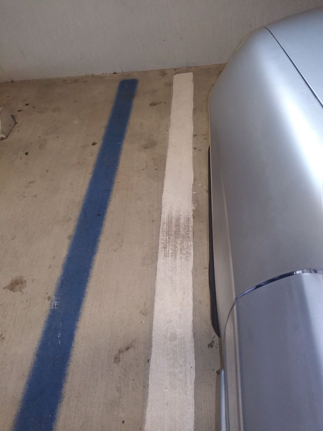

Finished installing struts and now one wheel is bent inward and the steering feels loose and turning side ways byitself. I did put too much torque into the tie rod, since it was bad I thought putting some pressure was going to tighten a little more. Could that be the problem? And I have another concern about the strut mount and bearings, when I tightened the center nut, the bearings felt hard to rotate so I loosen it up slightly. Is this the way it's supposed to go? I didn't know the center nut rotated with the strut? What about the friction it does?

i just had put wheel back on, didn't had phone on me and I live in a place where I can't do mechanics. Has been stressing working like that.
Passenger side
Driver side

Center nut on the strut should be seated all the way down and tight (about 32-36 lb/ft if I had to guess). The bearing should rotate pretty easily and should move nice and smooth.
Did you mark the location of your old tie rods when you removed them? If the new ones are far off then it could make one wheel have more toe then the other.

So you just popped them out of the strut and then reinstalled after replacing? Didn't replace the tie rod ends at all.
It's possible the old struts were bent but an alignment fixed it. It's also possible the new one is bent, an alignment should fix it though. For the time being you can adjust the tie rods yourself to get it at least somewhere close. Definitely need an alignment before new tires.

Wow, you got it right I think. A year ago I had hit one of those road sidewalk right up front on driver side wheel and the steering slightly twisted to the right. I was passing by a bad time and so I took it to a alignment shop. Now that you say I always had the worry is anything got bent or not. So this might be the concequences now. How do I fix it now to be able to move the car?, besides the Tie Rod adjustment are there other screw to play with the alignment part. I have no clue what they do to it at alignment shop but I'm going down under today in a while to see what to do.

On a 7th gen I don’t think you can adjust much except toe which is done with the tie rods.

i was able to adjust and appeared quite simple not complicated as I was worrying about.
