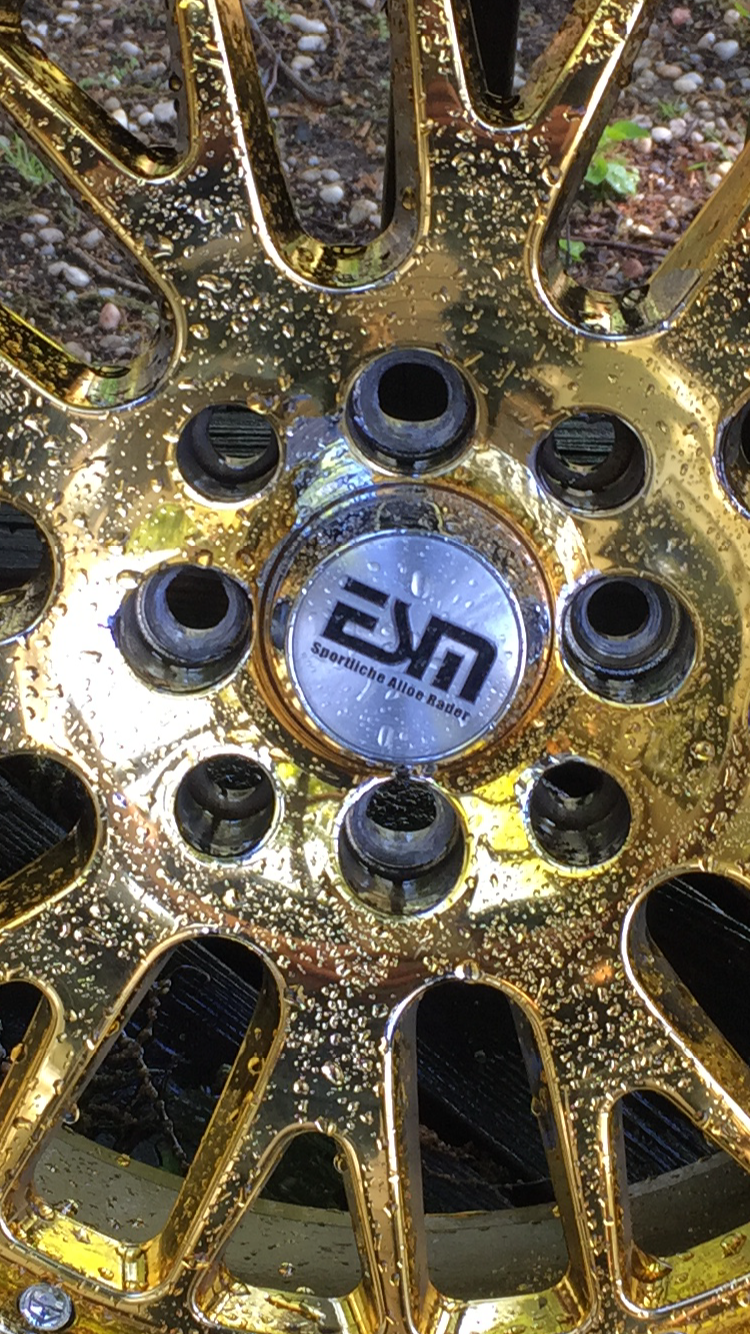

Ok I knew it was a risky idea with the eBay coilover sleeves so please don’t mention that part. My problem is after all was said and done on the install I had a bad tie rod end but decided to rig it up to work for a nights to get me home. Things went south and the wheel started to death wobble, at first it was mainly on deceleration but then progressed to doing it constantly. Limped it a few more miles then a wheel stud snapped from the wheel constantly wobbling, after the stud snapped I stopped and had it towed home. The next day I replaced the tie rod end, all four studs on my driver side, and replaced the lower ball joint since it was also no good anymore. Now after all those parts were replaced I drove it a few miles (ride quality is terrible as expected from a $20 investment) but my wheel still ended up wobbling and once I finally limped it home again I noticed all four lugs had come loose and they had been torqued to spec before the final test drive. The only thing that remains damaged to my eye is my wheel where the studs wallowed out the holes so now there oval instead of round. Does anybody have any ideas on what could be causing it to still wobble? The passenger side is still all stock components and hasn’t given any issues yet.

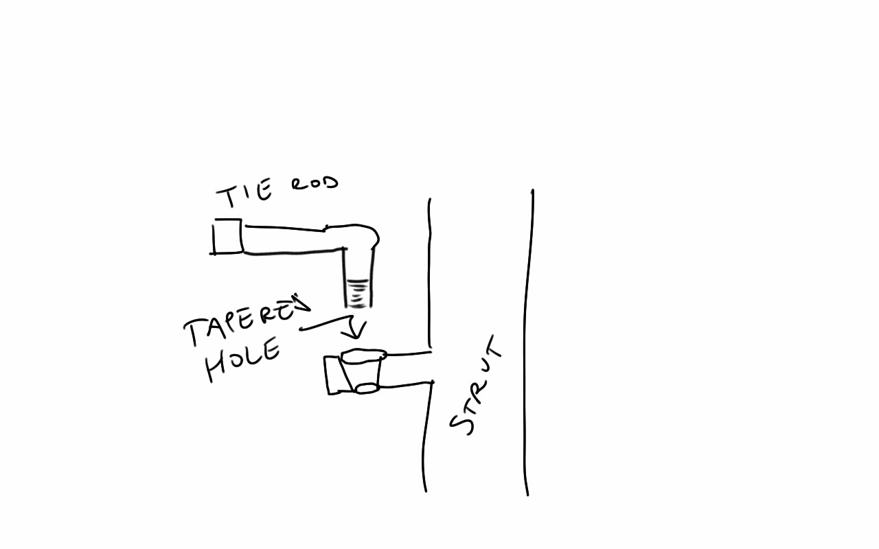

Check the hole in the strut the tie rod sits in, too. Death wobble could've opened that up, too. That hole isn't a straight hole; it's tapered at the bottom.

So I glanced at it this morning before I left for work and the hole in the strut for the tie rod end looks fine, no fresh shiny metal, no wallowing. But Riceboy I see you said it’s tapered? Could you possibly show a pic describing this taper?

Included is a pic of the wheel that took the damage

Ok so I got home put on the spare tire on and drove it around a couple blocks, made sure to accelerate hard some to put a little stress in the wheel and the roads are already bumpy around here so the suspension got a little test too. I didn’t feel any wobble at all. When I got home a checked all lugs to make sure they were tight and none were loose. The spot where the tie rod goes through looks good and so does the top of the strut mount. I’m starting to feel like I can come to the conclusion that it’s the one wheel causing the problem.. at least from what I’ve come across so far

Cool!! Sounds like the wheel was the issue that went bad due to the initial wobble from the tie rod.

looks like you have your issue figured out (full disclosure, too lazy to read the responses after you asked about the tapered hole. It's been a long *** day. lol)
To answer you question you had for me about the tapered hole, I drew it up on my tablet. The tapered hole in the strut has been drawn exaggerated to illustrate what I was talking about.

Well unfortunately it’s time to retire the 17s then. Kinda a blessing and a curse with these things. Get all kinds of comments but they always rub lol. Really appreciate the feedback and help guys! And back @Riceboy i understand what you’re talking about now, when we remove it I didn’t even notice that it was tapered, just to be 1000% sure it’s not the tie rod end again I’ll pop it out this afternoon and put it back in making sure it sits properly in that hole. Just for safe measure, don’t need my wheel almost falling off...for the third time.
