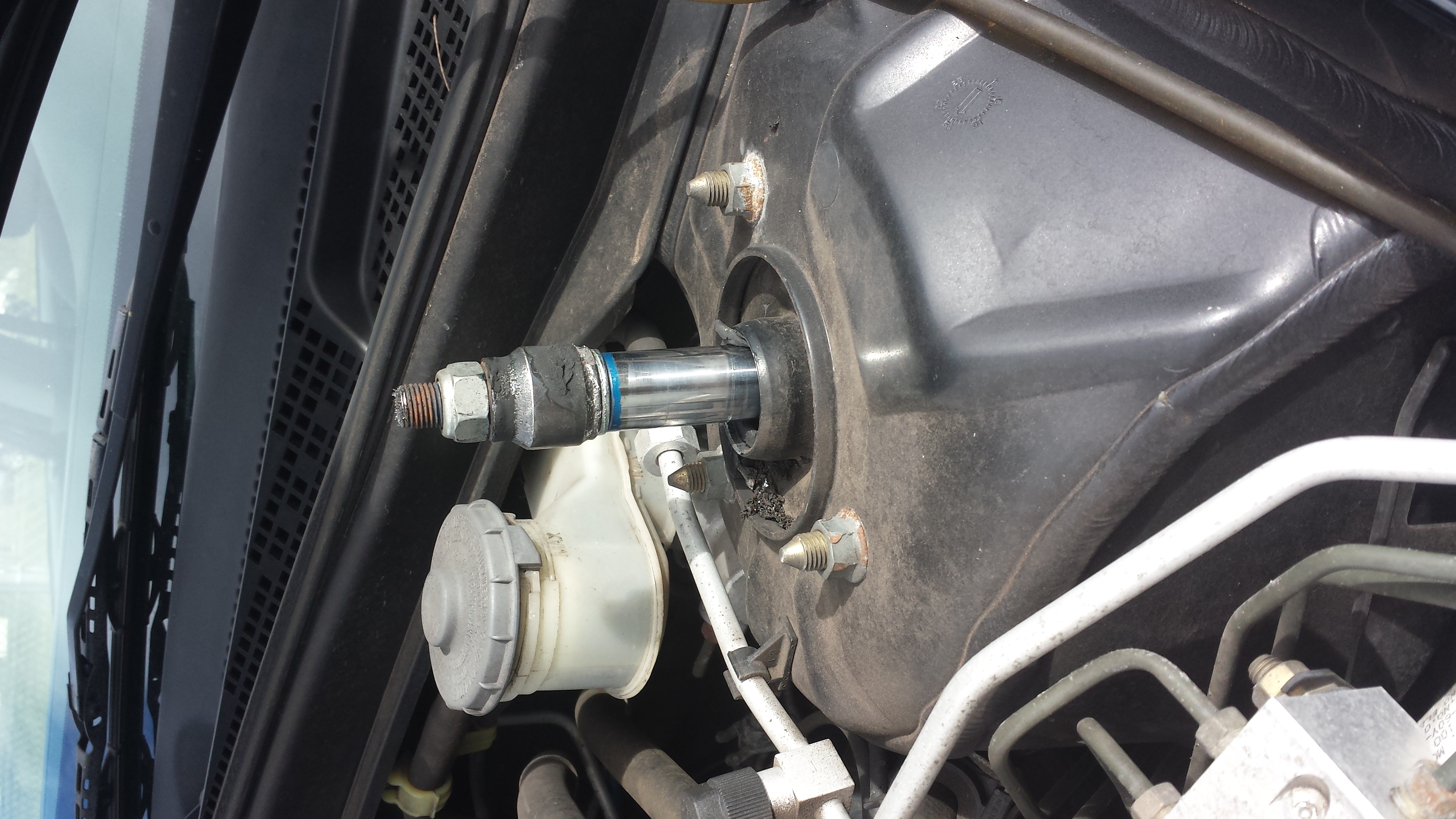

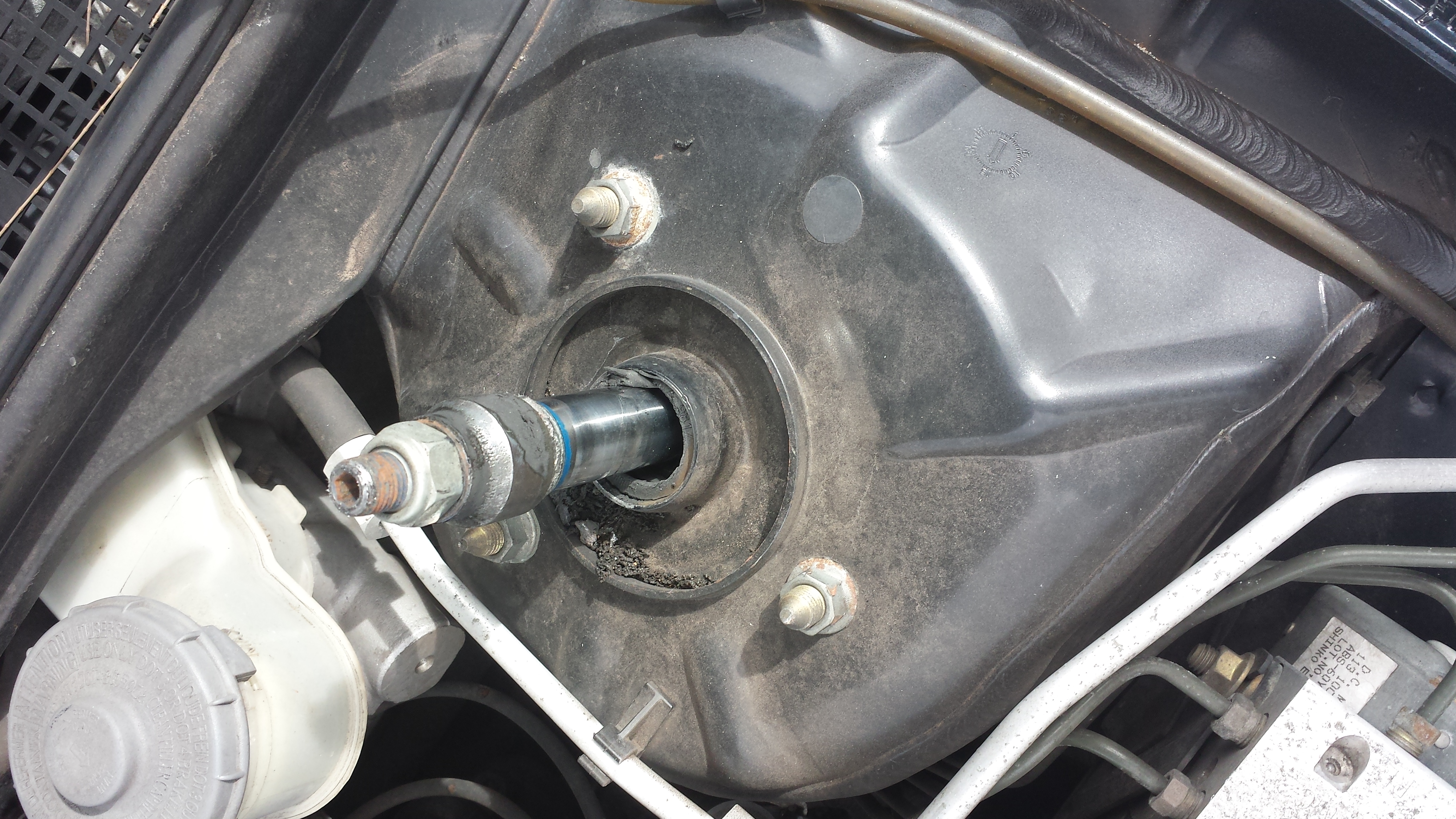

Thaik, did you replace your struts yourself? Which spring compressor did you use?
I have a far fetched theory about what this clunking noise is. I started noticing the noise right after I did the struts. I think it's the upper spring seat which is the round metal seat the spring nestles against. I think it's slightly bent and the spring pops against it every once in a while when driving on uneven surfaces.
How did it get bent? When I had the spring compressor on my struts I remember that when the claws were pulled tight against the springs, the threaded rod of the compressor was pushed very tight right up against the spring seat. It pushed into it even harder for each turn i put on the spring compressor nut. I'm wondering if that was enough to bend the spring seat slightly so the spring looses its indexing over bumpy roads?
Sorry for the super late reply. I intended to reply right away, but probably had something to do and forgot.
This is what I used:
I do not believe in my case that it is something related to a coil spring because the noise started occurring way before I replaced the struts.

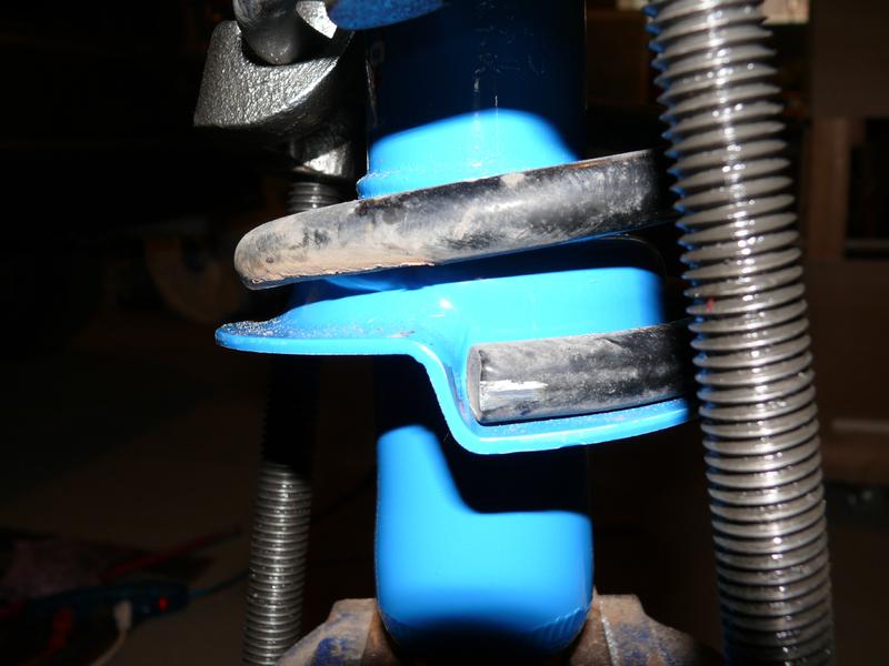

Did you index the springs properly? If the spring is not sitting properly in the strut mount it will pop when turning.
Old Jul 31, 2014
  #42
Thaik's Avatar
Joined: Aug 2011
Posts: 314
Rep Power: 184
Thaik will become famous soon enoughThaik will become famous soon enough
Re: Suspension front clunking noise, strut mounts?
I believe so.
By indexing you mean like this? (Picture attached below)
These are the rear struts though, but I did the same with the front.
Or
Are you actually talking about aligning the strut mount properly with the chassis, because I did mark the strut mount and spring together before removal, and I also oriented that mark towards the the engine bay of the car, if that's what you're talking about.
Btw, the noise was there even before I replaced the struts/shocks so..

If you watch this clip at 2:01, there is a big gap on at the bottom where the spring ends on the oem struts. I have check my koni orange and see if that gap is there.

Hello. I am an owner of an 02 Honda Civic EX. I have been noiticing a clunk in my front left for a couple months. I finally got it to a mechanic today. I popped the hood to find out what could be causing the noise. Any thoughts on what this could be? It looks bad
ID:	88893   Click image for larger version

you need new front struts, better off getting the entire assembly, way easier to replace it that way
Wow! Looks like it tore right out. You need new strut mounts.
