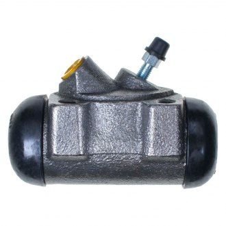

random google image:
the black rubber boot is what popped off?
its just a dust shield to prevent stuff from messing up the actual seal. Might want to check the other wheel cylinder and see how its doing. are they original? may be time to replace those as well

yeah the black boot came off that seals around the piston, there are two of them but only one came off, a bit of fluid leaked out, and i popped it back on
