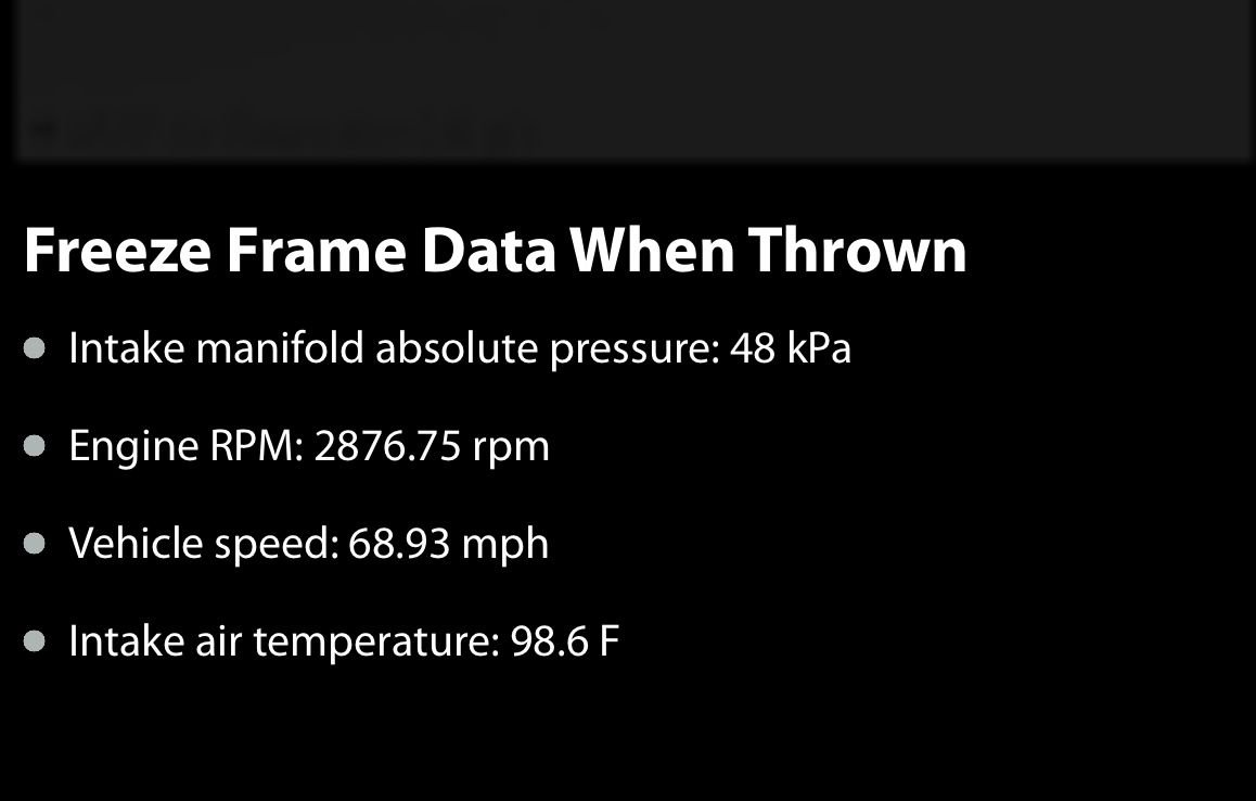

I was driving with my cruise control on the other day and felt a jerk all of a sudden, then my CEL came on. I had to pull off the hwy, was losing power. It was code P1361 TDC Sendor malfunction. Have you ever thrown the same code before? I want to be sure that the sensor needs replaced before I spend the $60 .

p1361 I’ve read is caused by the camshaft sensor, but I’ve also read it was the crankshaft sensor. When I changed my head gasket last summer i remember there being 2 sensors in or on the timing belt cover. One was the rubber plug one im the middle, then another one was pointed at the crank shaft on the bottom of the timing cover. Do I need to look for a crankshaft or camshaft denso sensor? Thank you
trevor
here is a pic of the freeze frame data when I threw the code:
