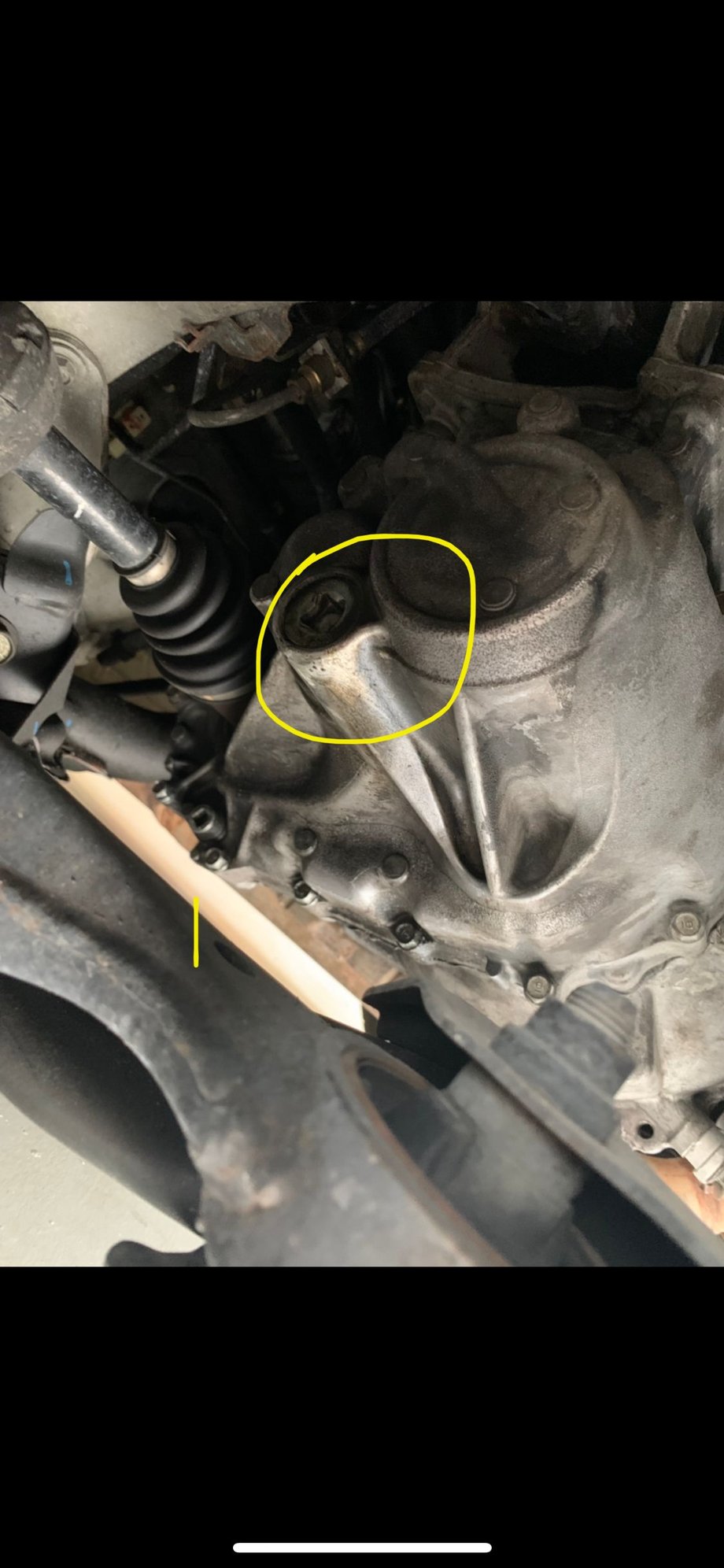

So I have a very mild trans leak and it seems to be coming out of this plug I know it sounds stupid to ask, but I don’t want to mess anything up The yellow circled plug is what I am asking for Where the yellow line is , that is the drain plug ( for reference)
Manual trans btw
i am gonna change trans fluid and replace the crush washers for both plugs. But I want to fix the leak too
im not sure if I can remove that 1/2 inch plug and use thread sealant?

It's been a few years since I've had one of those apart. I think there's a spring and a ball behind there. If you find a trans tear down video, there might be a thread here with pictures. Should just be thread sealant on there

Idk why I didt think of watching a trans tenfold video lmao. The plug just comes out, no spring or *****, and apply thread sealant. Thanks for the help though
