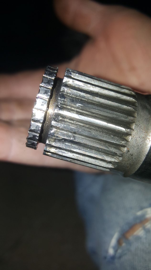

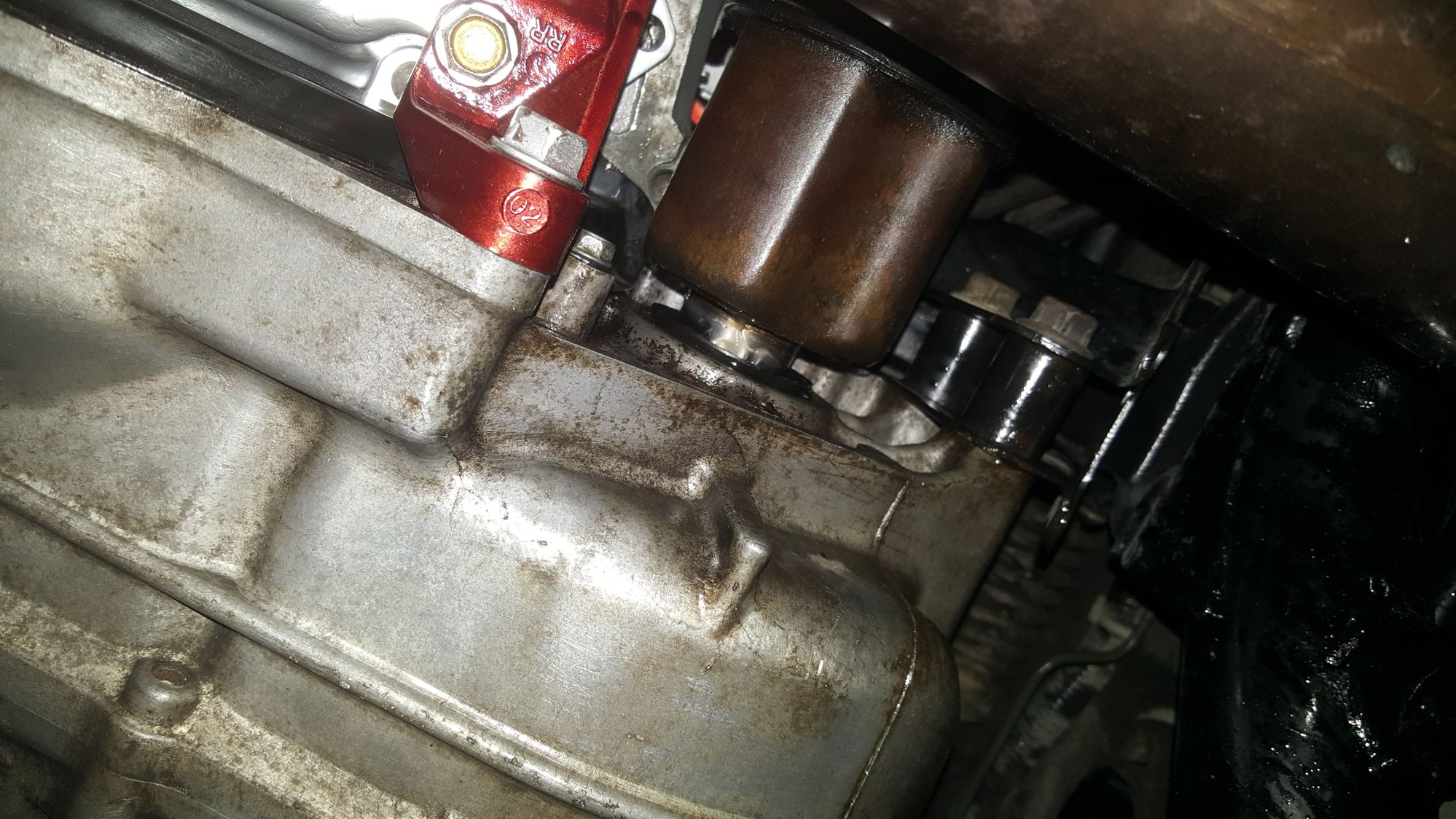

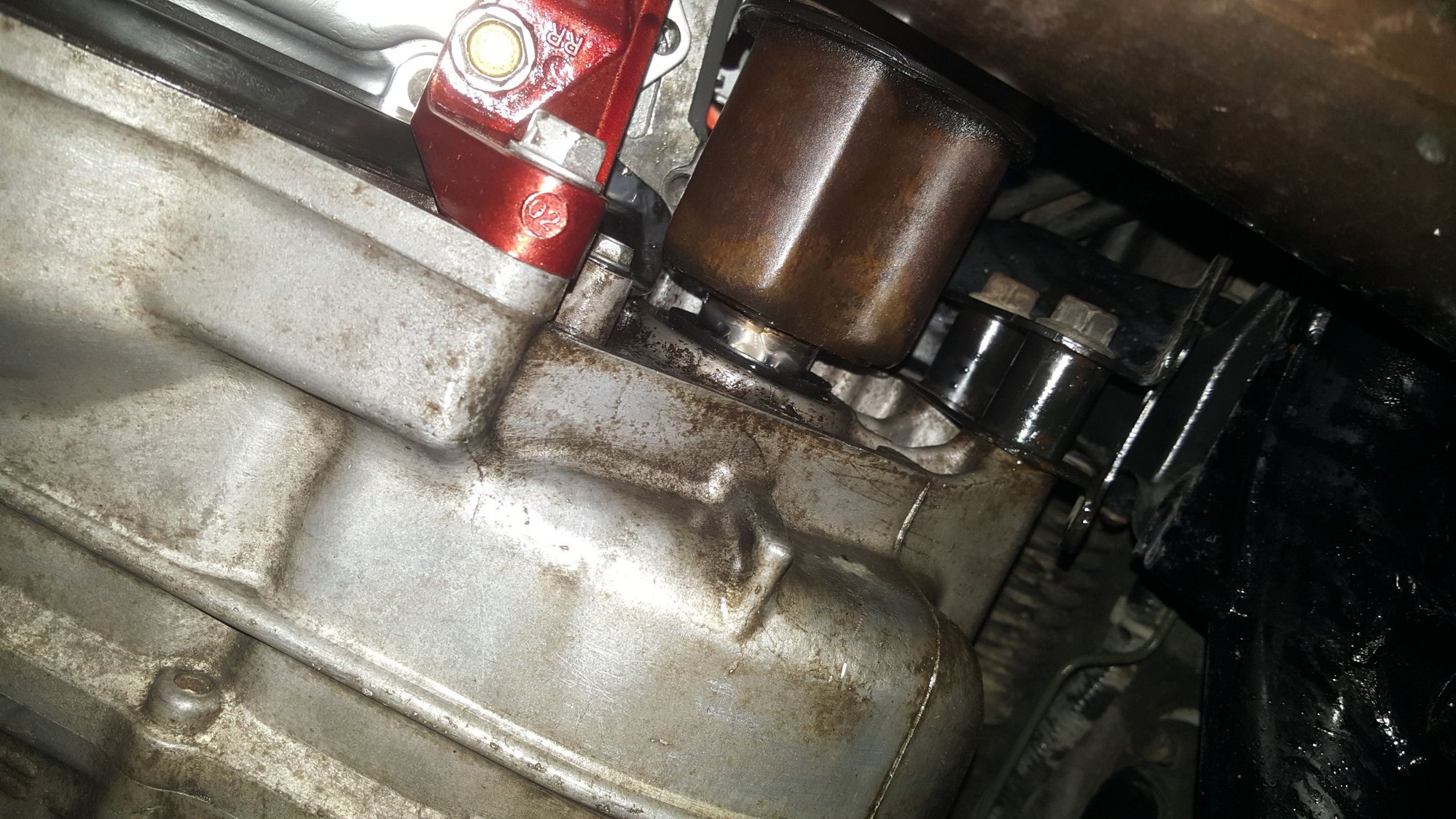

The first 3 pics are of the drivers side axle where it goes into yhe transmission.
The next 3 pictures are of the same thing but of the passenger side.
I got under the car and found the leak came from what appears it could be the seals, however I was told the cv axles may have not been properly reinserted during assembly, causing one or both to "pop" out of place; which explains the pop noise and leak.

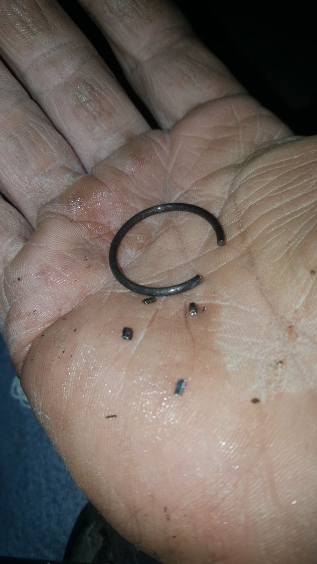

My reluctant, stubborn, and persistent idiot of a DIY tried very hard to get it in gear and it shows the product in the last 2 pictures which is the end of the passenger axle that goes into the transmission.

Both of those axles don't look like they were seated correctly, are they aftermarket?

Factory original. Car has 154,412 miles, no wait 154,418 after that first drive on the rebuilt motor.
I was also thinking the same thing with regards to the both of them not being properly seated. My question now pertains to preventing any further damage to the internals (referring to the transmission). What do you recommend I should do in order to ensure proper function and operation when I install the replacement cv axles. How would I also go about checking the place inside the transmission where they are to be seated as to inspect for damage I may have already caused from the grinding and spline pieces I've successfully damaged.
