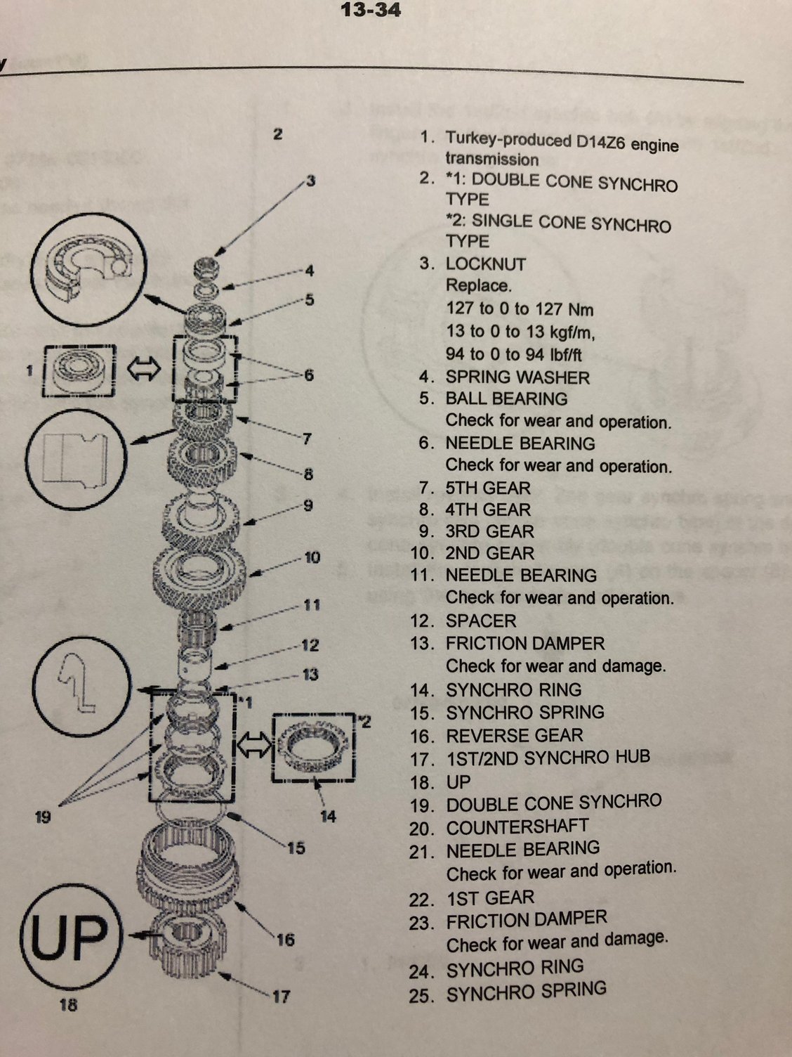

Just wanna ask what is really the torque spec of a 7th generation civic (2001-2005) transmission countershaft locknut in ft. lbs.?
I've read here somewhere here that it is 65 ft lbs, and other says it is 80ft lbs? I am a bit confused here if which really the right torque spec?
Can soneone chine in on this one, thanks!
I am near finishing rebuilding my 2001 manual tranny.
been lurking around cant find the right answer.

What does the factory manual say?

Downloaded one from this forum, but I think this is from D14 Civic.( the megauoload version file name is EM2 repair), but this is a bit tight.
I remember when I open my countershaft locknut, I felt slight tight and with no so much effort.
Would 80 ft lbs. would be safe? like inbetween 65 and 97ft lbs.?
please need opinion on this...thsnks in advance!
