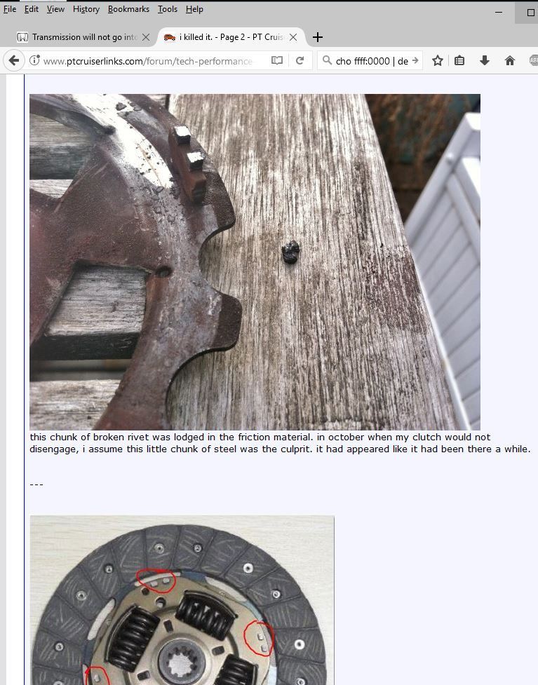

with the PT, i was getting on the highway and i went to shift quickly into 4th and i hit 2nd instead. the clutch locked up and i drove 20 miles home not able to use the clutch, luckily like you my skills allowed me to shift without it. i have a pic of the cause from that one. the "reverse yank" fixed the PT as well. so 3 for 3 on this working as a fix for me.

if your car is behaving like i described above in bold and you aren't afraid to try it, yank it into reverse at idle once or twice. it'll probably clear whatever is wedged in there. you wont harm the trans. i never did
