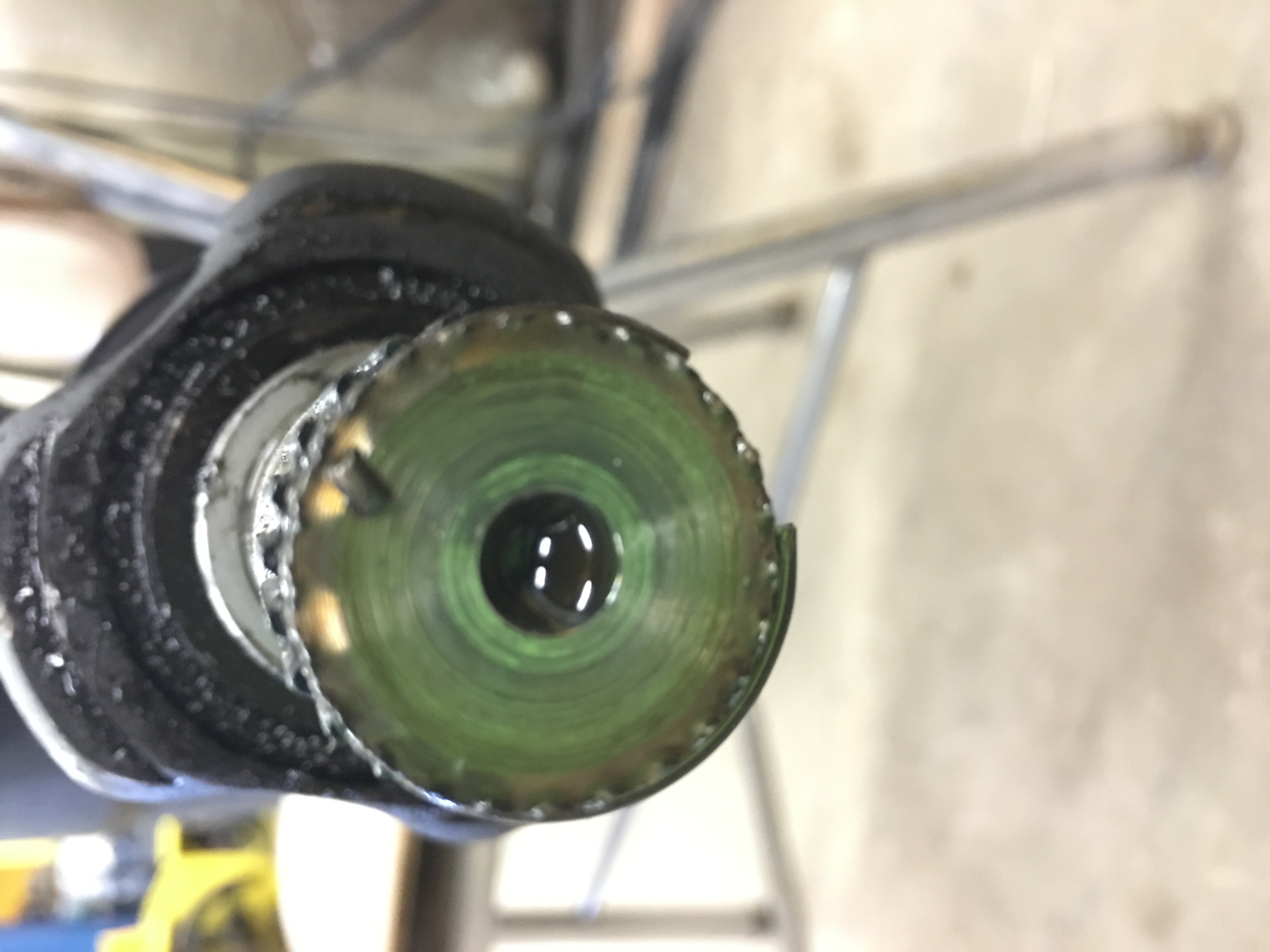

so i put the car in the lift today turn out the driver side axle pop out im going to see if it goes back in if it doesn't im going to replace it any other suggestions?
Old Mar 5, 2016
Re: trainny issues help please
If the axle does not pop in and latch securely, there's a problem.
If it doesn't latch, pull it all the way out and see if it sheared the end off at the snap ring groove.

It did shears a bit of the end should I replace it anyway?
Yeah if they will exchange it, I'd replace it.
Hope the shavings from the splines on the end don't cause other issues in the trans later on.
Question would have to be, was it not fully seated when you assembled it, or was the snap ring weak and couldn't keep it from popping out on its own?
