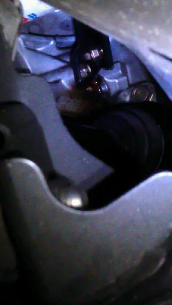

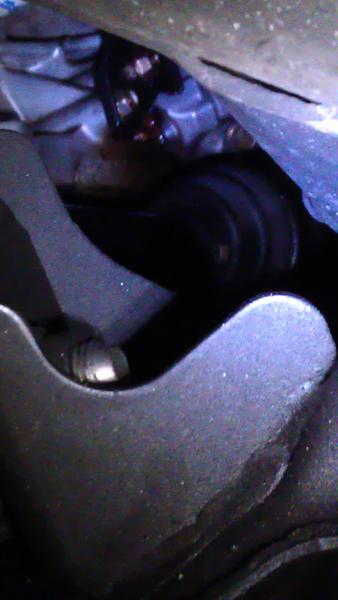

well if you wipe some of the oil that is leaking onto your hand, or onto a cloth, you should easily be able to tell the difference.....tranny fluid will be pink, engine oil will be brown/black
1st time i checked the oil it looked dark, kindda black/purple.
2nd time it looked dark/gray.
last time i checked it looked black.
well heres a picture, i took it 4rm the driver side, behind the wheel.
i was just getting home 4rm work, when i looked at the engine 4rm the inner fender well, some smoke was coming out, and this area, right under the 2 golden bolts, witch is were the axle boot is located that connects 2 the tranny
ID:	84671   Click image for larger version

Problem fixed, it was was my axle
