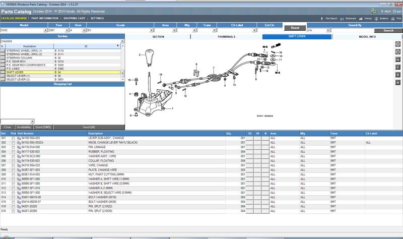

If anyone is still paying attention to this thread can you please help me determine which part to replace? I am having this exact same problem, but I deliver pizza and I need to fix this fast so my car will last me another year!! I read all the replies and realize I need 'shifter bushing', but I know nothing about cars (except how to change the oil?). Please reference this diagram and tell me which part? Thanks
-A forlorn young woman with no car experience
PS The diagram is in the attachments. A honda dealership sent it to me when I asked if they had the part, they also don't know which one I need xD
