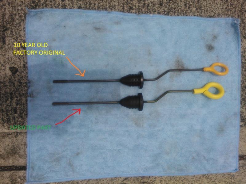

Re: Tranny Dip Stick Not Tight...!
The stealer ship had one in stock. The fit is a night and day difference.
You lied ezone. You said it would be $11, it was $14. I broke the bank LOL .
Anyway, I attached a picture for comparison.

Old Jun 15, 2012
Originally Posted by Matt_75
The stealer ship
Yeah, I F'n lied to you.
The REAL MSRP is $10.52 (USD) for part # 25610-PLX-003. http://www.hondaautomotiveparts.com/...EEDOMETER+GEAR
Now then: Is your state tax around 34%, or does your dealer charge that much for the privilege of setting your dirty feet inside their fabulous building?
It's still dirt cheap IMO.
