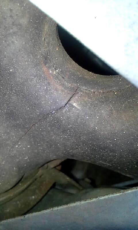

checked sparkplugs everything is fine with those while checking them i noticed my cat has two big cracks on it :0 i attatched the photo and my 89 hatch is manual freakin love it! lol

Re: 03 Civic Lx Auto tranny headache
Typical.
Probably makes that snapping noise when it's first started and stinks of raw exhaust.
May or may not get quieter as the manifold heats up.

Originally Posted by ezone
Typical.
Yea that sound sometimes goes away after its become hotter it's always loudest at start up

If you're having a misfire, I think the car would be sputtering. We just had a coil go bad because of a valve cover gasket leaking oil down into the spark plug area. It fouled the spark plug coil and needed replaced along with a new gasket. That fixed our issue.
As for the manifold crack, our '02 LX Civic has one too. I think everyone does. Comes standard with the car.
